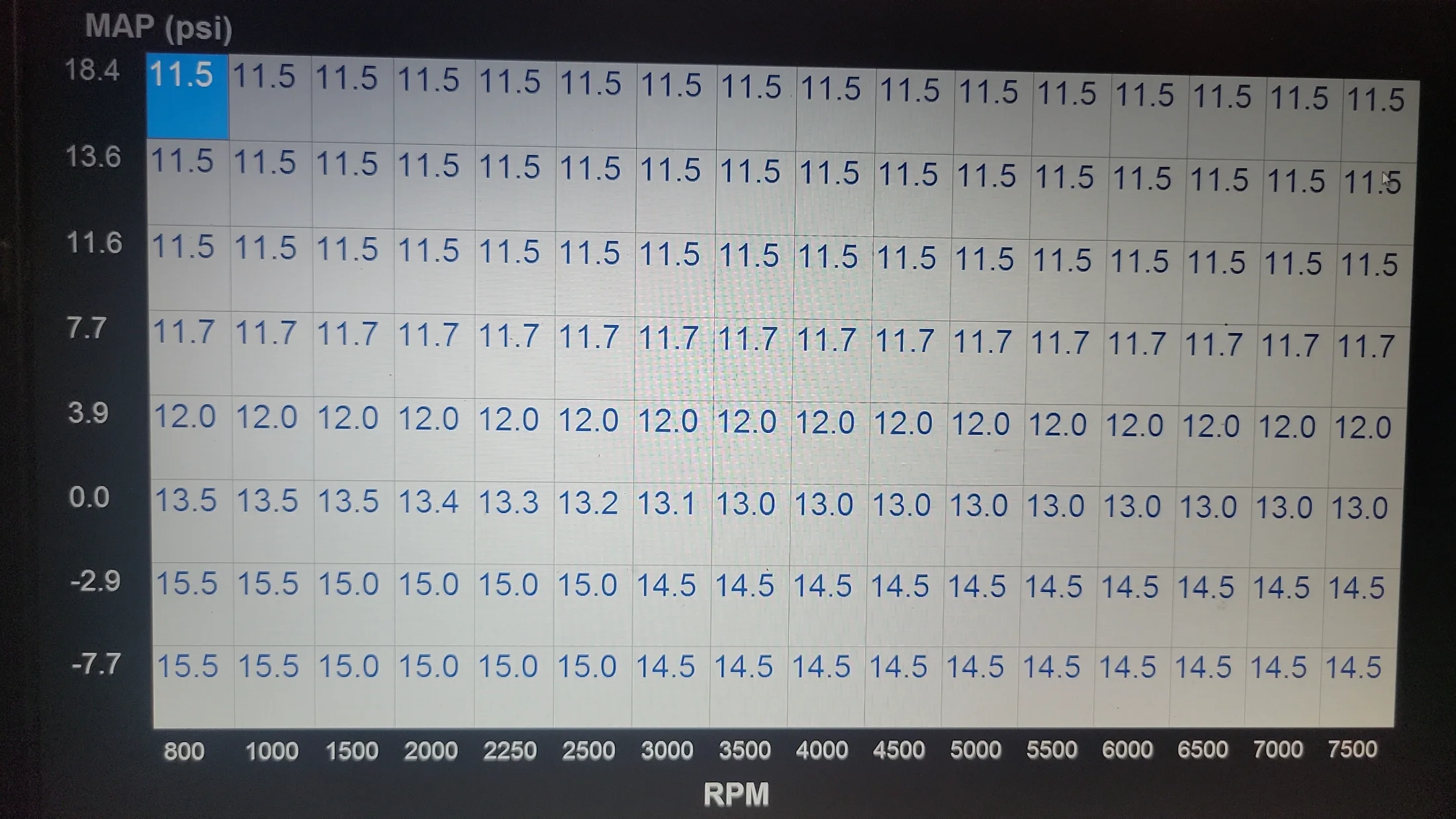

Running fuel off single table at 11.6 all in at the upper end of the spectrum and have fuel scaled to boost.
Now attempting to run timing off a single table.
I’ve already successfully negated the ability for the tune to move to other tables for fuel or timing.
I’m just stumbling on putting together the timing table.
Here’s my fuel table for review

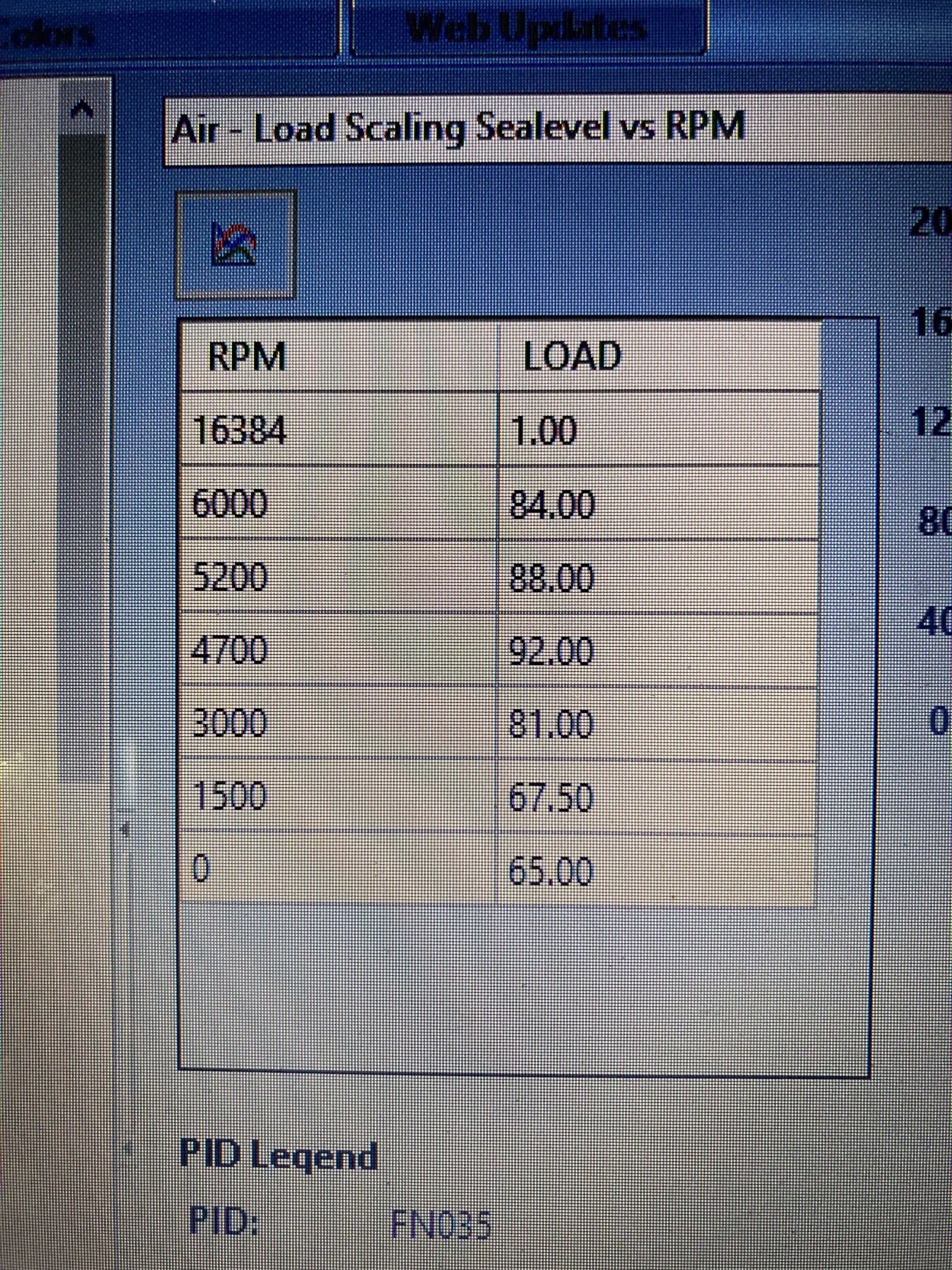

No but I’m about 92% VE at 4700 NA if that means anything
Not really. It's indirectly related to the VE, but I wouldn't use it to calculate CFM.

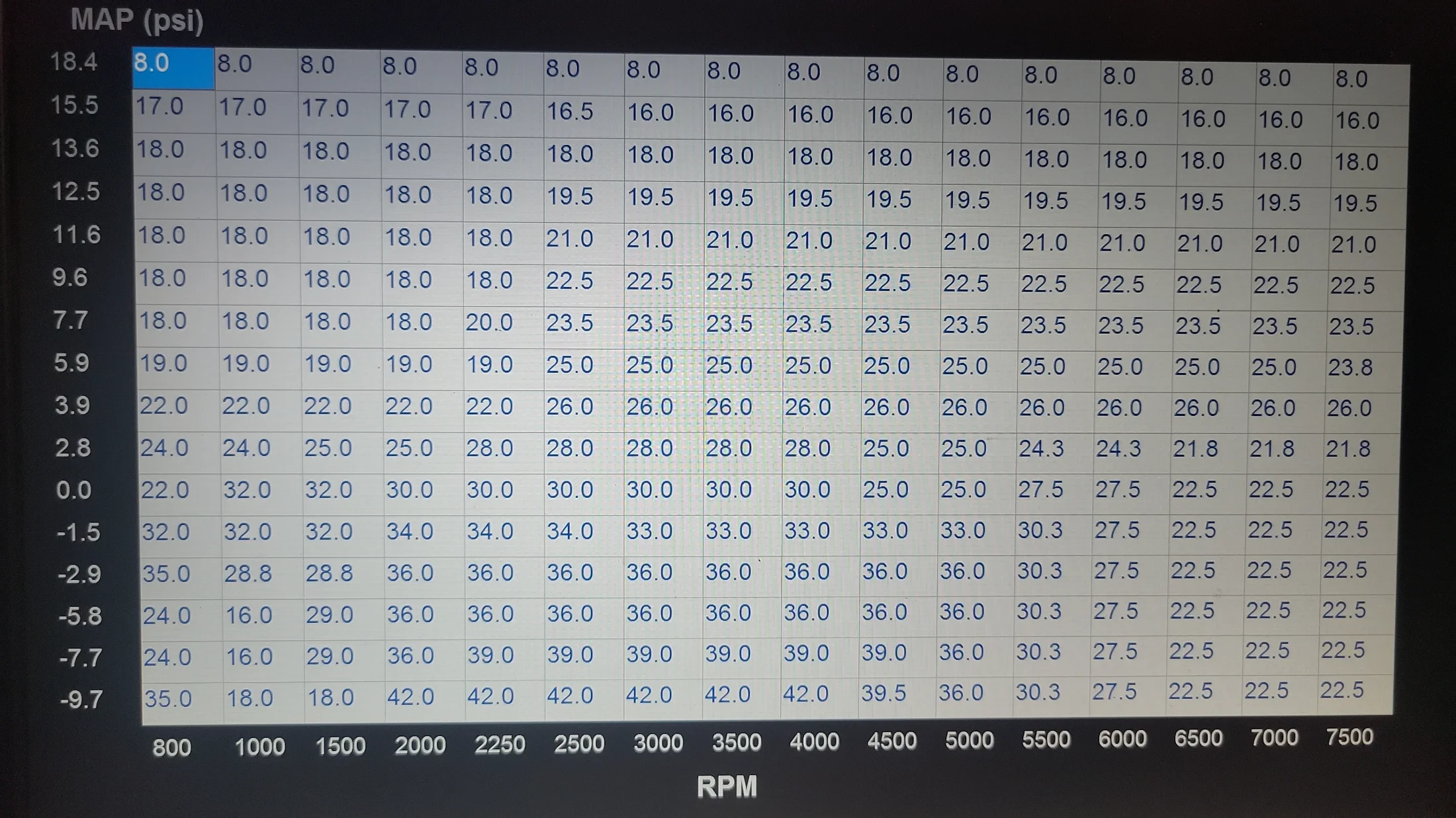

there is goes. FN904A - sea level spark table is the only thing I need help with
