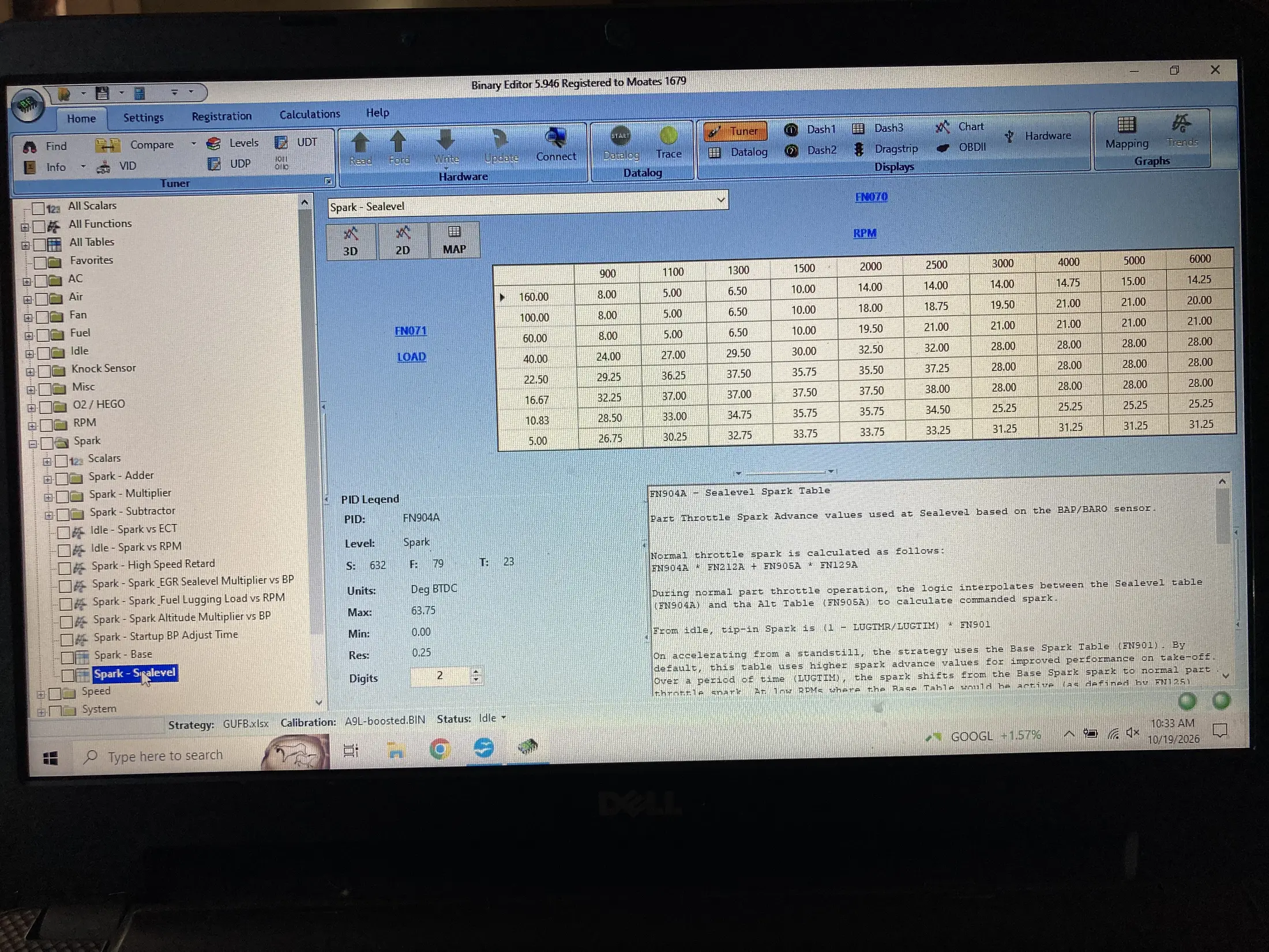

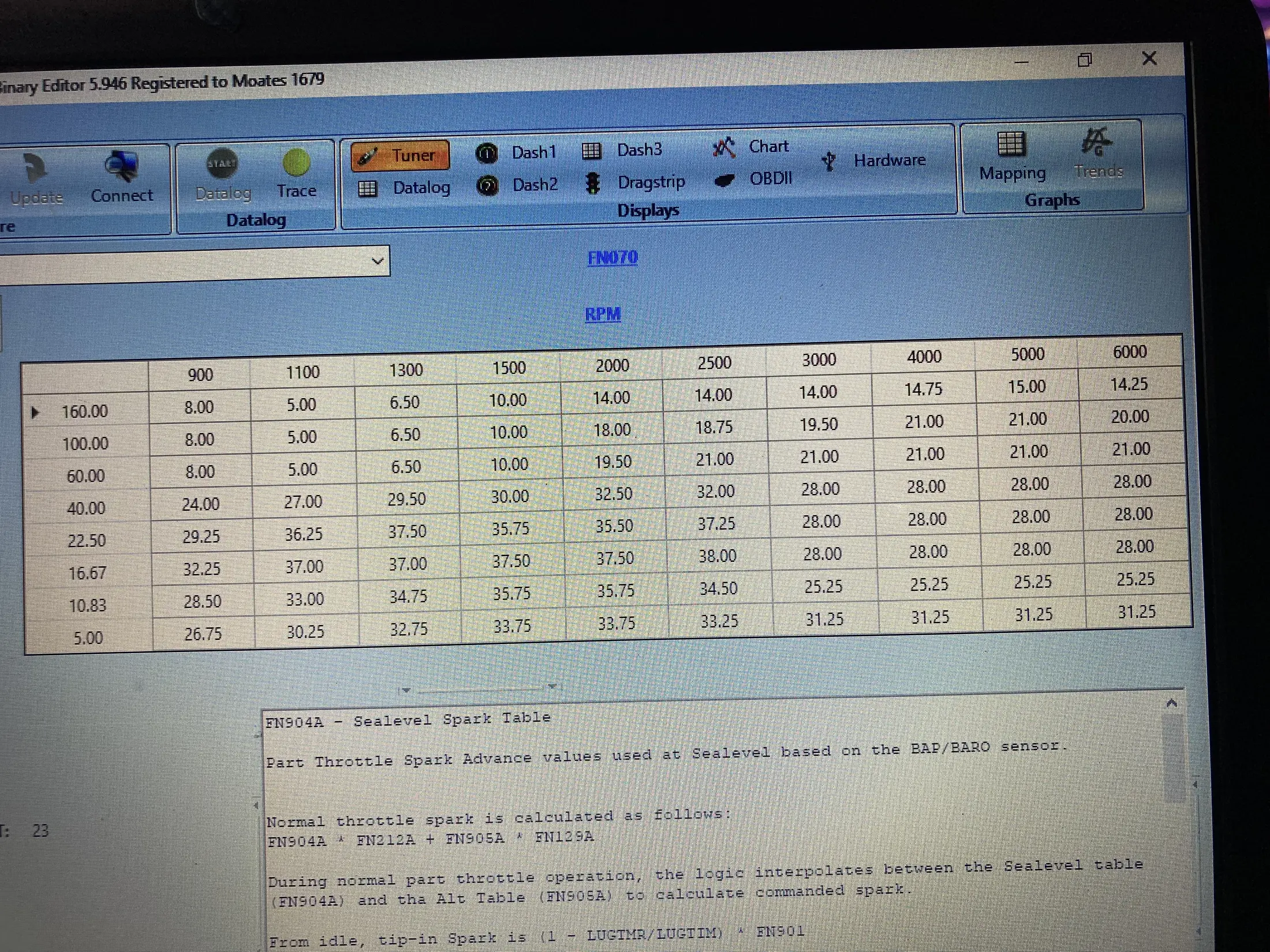

I wanted to show the modified sea level spark table for boost. The finished table is a bit different because the program only has 7 lines for entry and they make you leave the bottom line at 0 so you really only have 6 positions to make entries. The air loads I need to enter has 8 data points. So I had to skip the second and fourth on the entry table and the program averaged the two missing data points. Here is the result. Does this look ok to start with?
Sea Level Spark (only active spark table)
