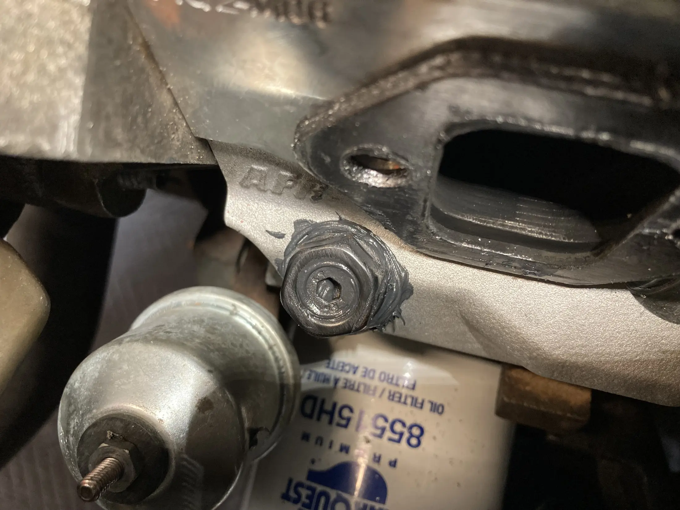

I understand. Albeit, the head is already cinched down entirely on its installation prior to all this. It’s not like I removed the stud and the corner of the head lifted. But there’s heat cycles to follow so who knows. If I cinch this down in the ballpark I think it will be fine. That’s with a prayer of course….

By the way I don’t think this bolt I bought from the pull out drawer at the local hardware store is TTY.

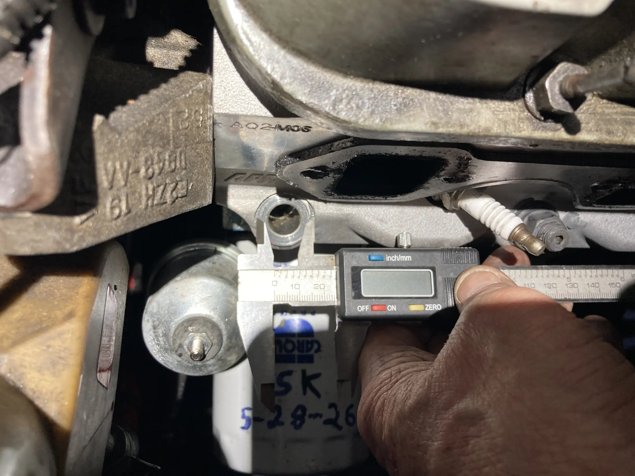

Gotta pull the header for assembly clearance either way so I’m working on that while I wait for special drill bit and tap. 27/64” bit and a 6” long 1/2x13 tap.

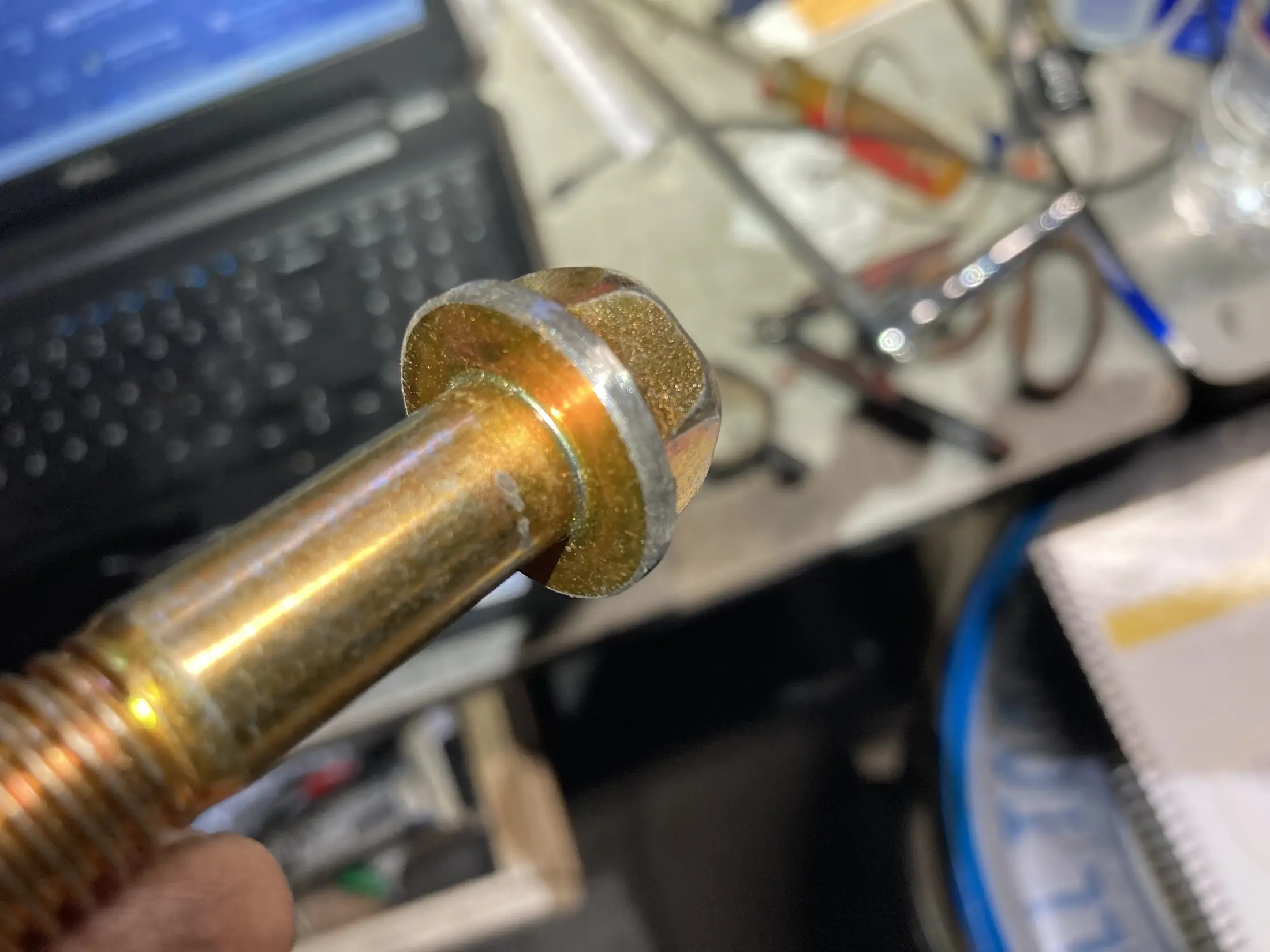

The diameter of the washer surface on the bolt was about 1mm bigger than the machined surface on the head. I used a bench grinder to take a little off the bolt washer so it fits. Glad I measured it
