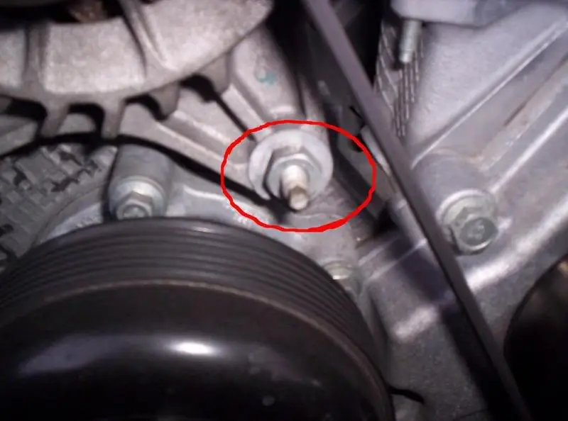

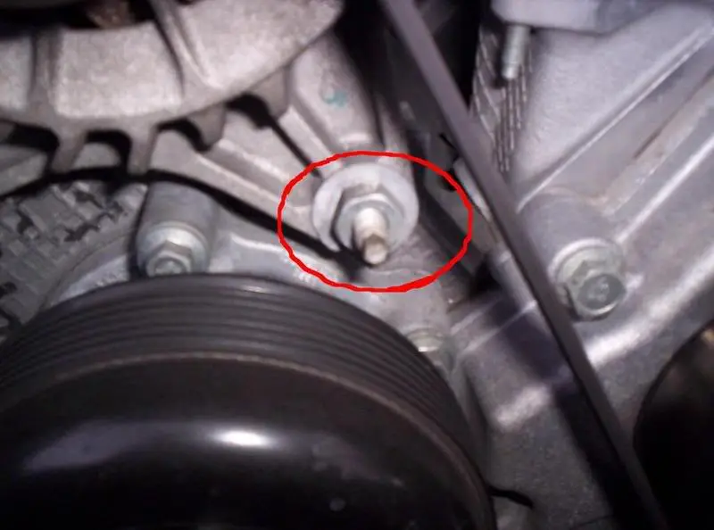

I have one suggestion, add an arrow to or circle the stud you're trimming near the water pump. The angle is different in the two photos and I can’t tell if you’re modifying the stud in the center of both or the one that is visible at the top of the first photo and not visible at the top of the second. If it’s the one in the center of both, then a before and after photo would be helpful.

here you go, this is the stud in question. it is the only stud there, so once you get under the hood, it will be obvious to you.

Thanks again BigCat! This is the stud I thought you were talking about but It's always best to be sure... You Da Man :hail2:
