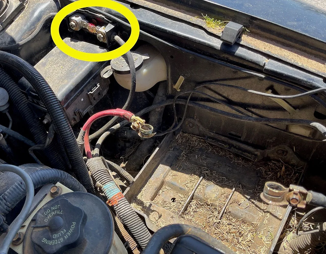

I'm not finding a metal box . . . but I suspect that this (yellow) may have been covered and it's in the correct position:
I can't find anything else in the general vicinity of the battery, although I notice a change in diameter of this (green) going into the fuse box (from the alternator?
The cable with the yellow arrow goes to the front of the fuse in the prior picture, and there is a hard plastic sliding cover over this bolt (blue) on the side of the fusebox.
Also, after replaced the fuse yesterday, it was battery voltage on both sides of the fuse weven with the engine running.
to be clear: the one circled in yellow, not the part in orange?>
Thank you.
Although I suppose this means that I need to pull the alternator to get at the voltage regulator . . .
A fusible link is just a smaller wire designed to burn up before the main one does. Essentially what the inside of a fuse does, only a bit bigger. In this case, the two smaller wires that split off the alternator output at the main fuse box are the fusible links. That other fuse you've found was added after the fact (I'm assuming an amp).
