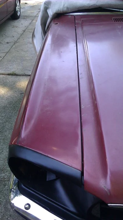

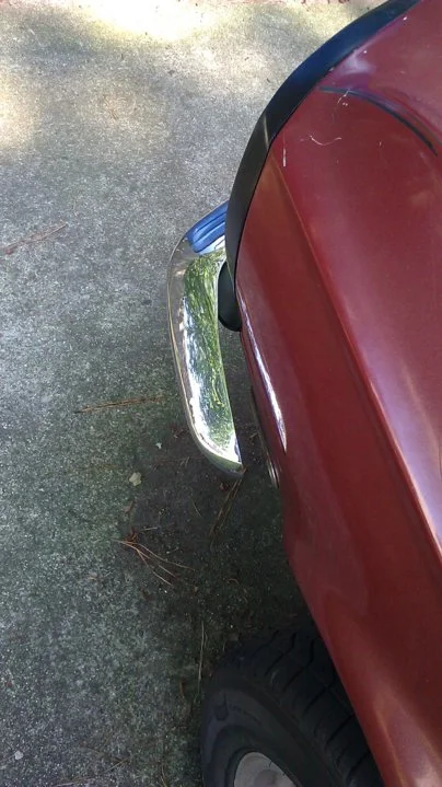

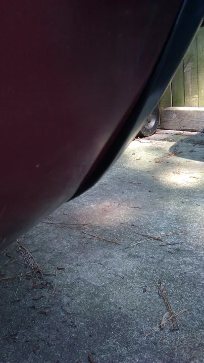

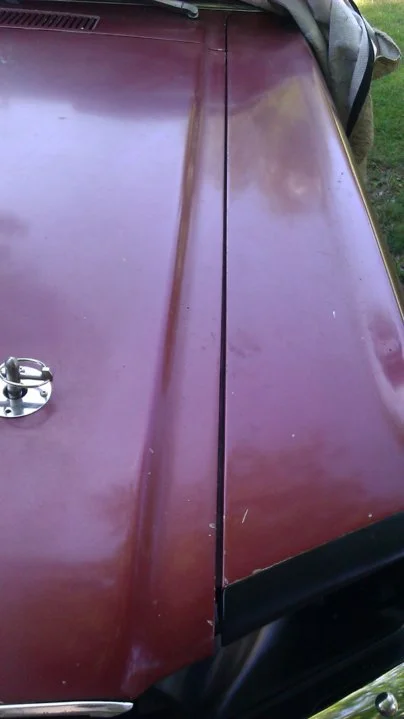

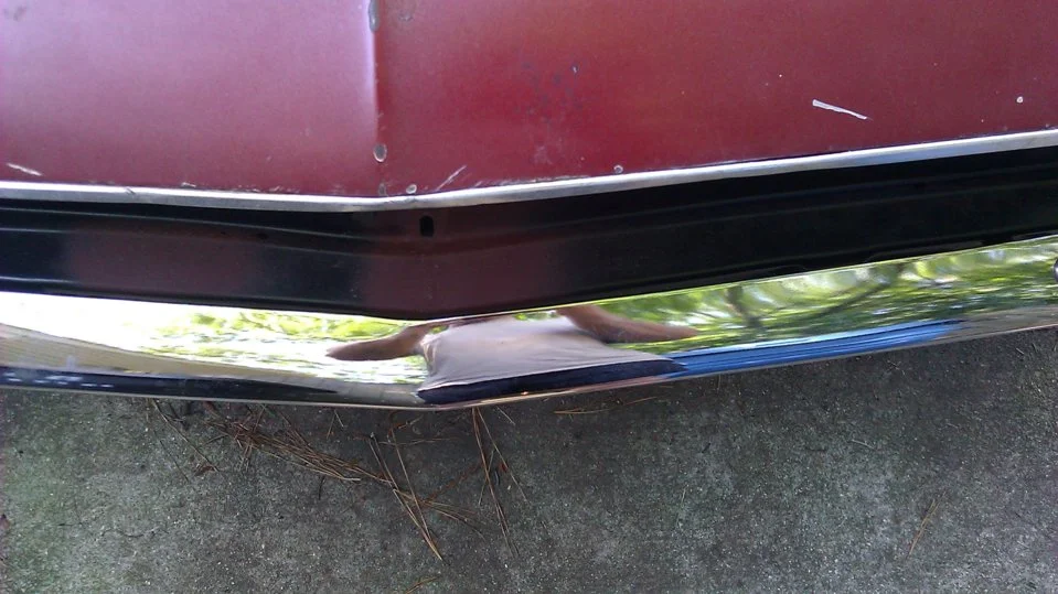

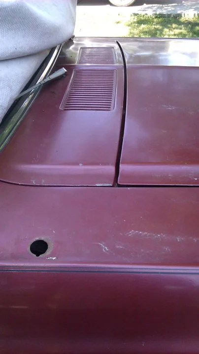

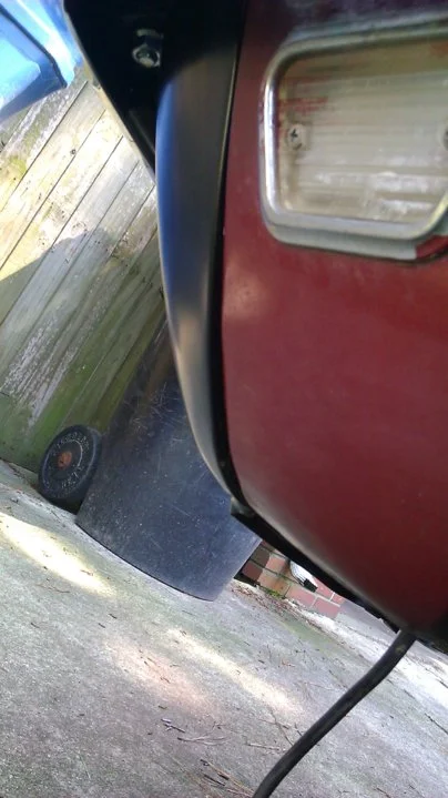

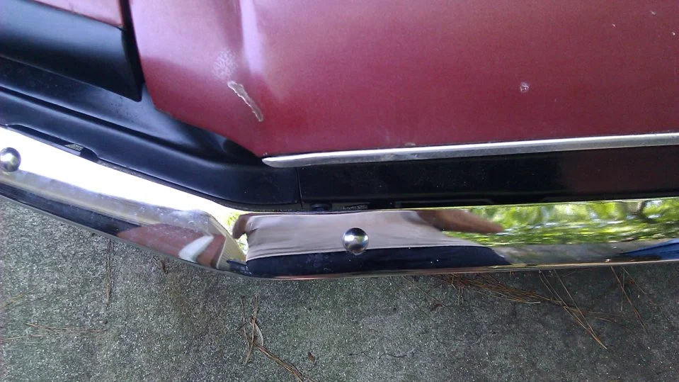

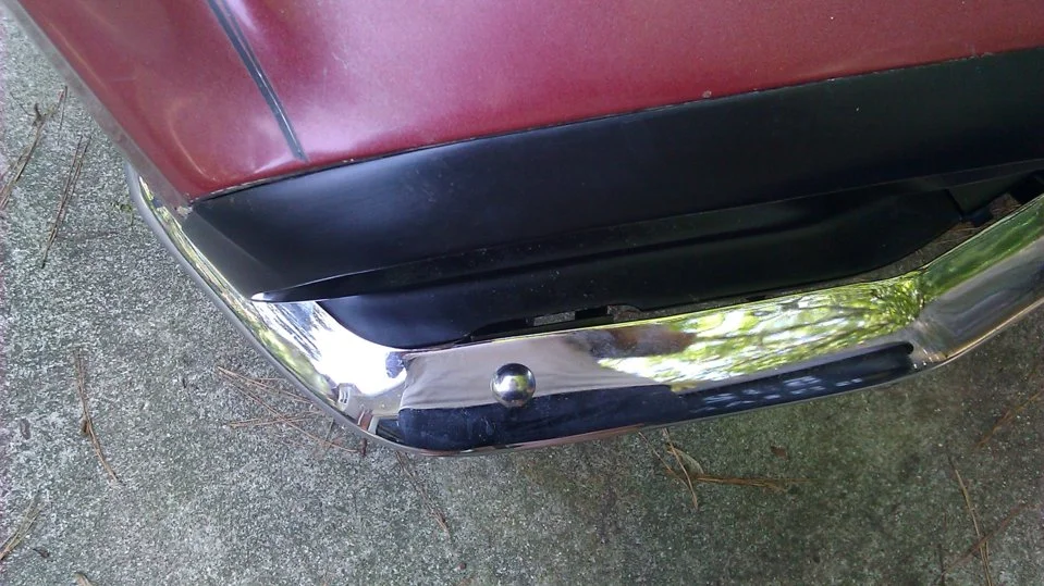

Man it took awhile to get back to this. . .Here is my first crack at this. It also illustrates, at least in my eyes, the poor fitment of new sheet metal. The biggest issues I see are that the ends of the valance are too round vs the fender, and the bumper needs to shift over another 3/8" to the passenger side but I've run out of adjustment. And, if I shift it over farther it will pull the bumpers center off to one side, lol.
So, what's the next step? What point do I stop shifting pieces, and make the decision to start cutting/hammering/welding?
Thanks!
IMAG0224.webp IMAG0225.webp IMAG0226.webp IMAG0227.webp IMAG0228.webp IMAG0229.webp IMAG0230.webp IMAG0230.webp IMAG0231.webp IMAG0232.webp IMAG0233.webp

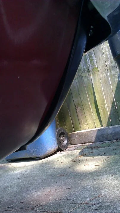

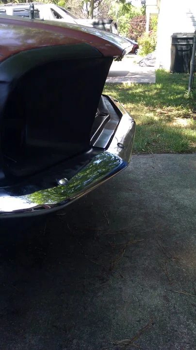

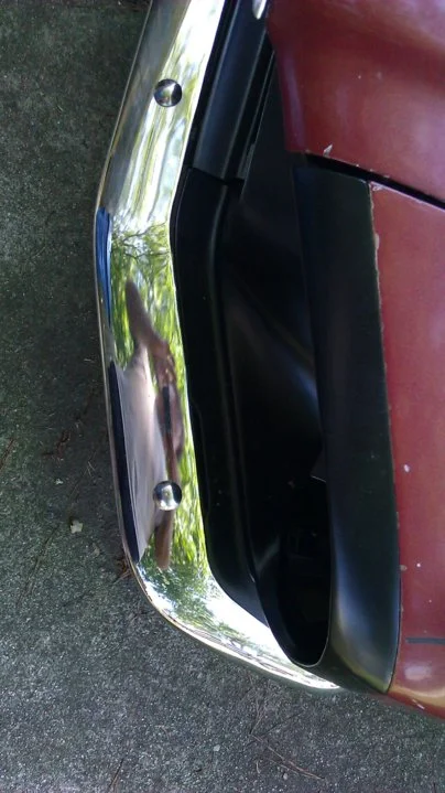

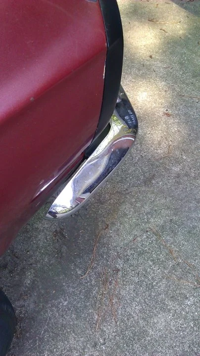

Valance end curves. Suggestions on how to pix this? I was thinking to cut the curved portion free from the lip that bolts to the fender, then fold/curve it to fit and weld it back together? Or should I order a new piece?

Is it possible your bumper brackets are bent ?
you may have the front sheet metal shifted to one side ,measure from the side of the front rails to the out side of the fender on both sides and see if they are the same .
Get some heavy ply wood and trace the front of the fender at the front valance ,cut the ply wood as smooth as possible and place it inside the valance .You may be able to clamp the valance at the top and bottom flange that bolts to the fender ,gently hammer the edge at the side of the lip on the valance until it draws the side of the valance in and touches the ply wood .you can use a piece of hard wood against the side of the valance to hammer on to keep from denting the valance ,or use a hard face plastic hammer . The ply wood will act as a form .

Hmm, I will get out there tomorrow and take some measurements. The bumper brackets are new. The originals were in bad shape. The plywood idea is pretty slick! I never would have though to do something like that.

So. . .there is a 1/4" difference to the drivers side if my rough measurements are in anyway accurate. but, that would require a 1/8" shift to the passenger side. . .which means the bumper would need to be moved even farther over to be passenger side to center up. I also put the tape on the bumper, and from the "center"(the middle point of the bumper) the bolts are off 1/4". Could be my measuring, but. . .
I did have a new bumper that fit farther to one side ...on a 67 fast back .The brackets were good and when i took the bumper back off i could see one side was in a different angle on the sides .I actually bent the side sticking out the most with a rubber hammer ,it really didn't take a lot to bend it .I would check the bumper again .Trace the bumper on a large piece of card board ,flip the bumper over and see if it still looks the same against the tracing .
So! I traced and flipped the bumper, and it was indeterminable really. . .so I marked the bolt holes and drew a grid on the tracing. Measurements on each side show the bumper is more or less equal. Everything fits OK, not perfect, but good enough. . .so I just opened the holes in the bumper brackets up so I could slide it over and bolted it down. Is that cheating? I also put the rear valance on which fit much better than the front. Still not perfect, neither is the new bumper, but looks good.
