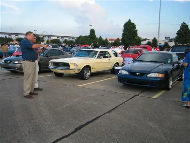

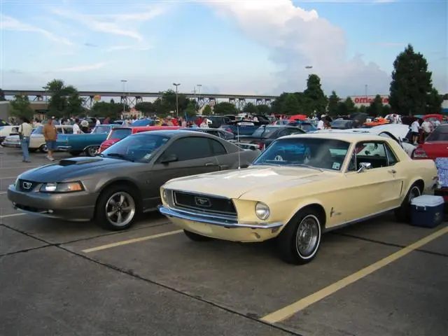

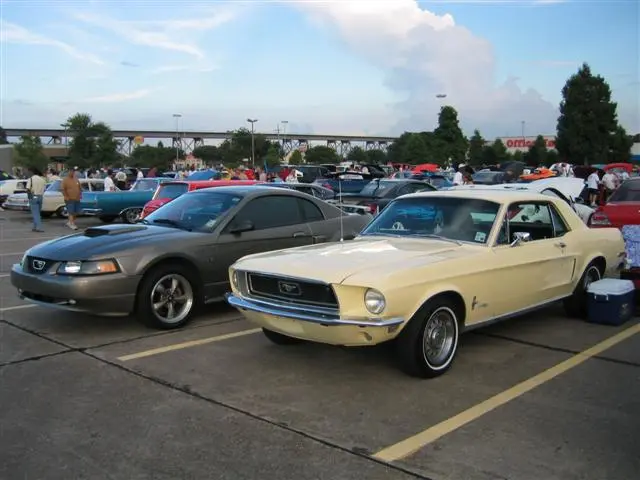

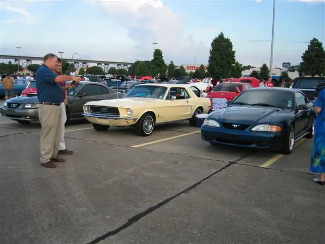

/me feels like posting pics now
our GT, Mike's GT, Kevin's GT - Opstangs :D
