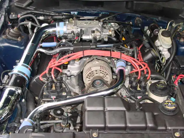

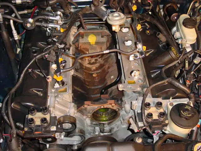

Just finished up the install of the PI intake with the adapter plates. It took around I quess about 5 hrs. I now next time if I ever have to do this I will wear gloves. I look like a cat attack me. Anyway the job was not too hard. I did by myself. I actually find that the cams were easier to install compared to the intake. Car runs good, but I am taking it easy until it is tuned (T&J). I will say one thing it does sound different. Actually louder.
The reason I wanted the adapters is so I can put a blower on in the future. Here are some pictures of the installation. It is a well worth bolt-on mod for NPI guys.

Nope. I used my old intake plenum and throttle body. The whole swap came as a kit. Coolant tube, water pump nipple, intake, and bolts. I do need a tune thou. After doing the swap I looked back and realize I should of just did the headswap. Pretty much everything was taken off except for the heads and front cover. Oh well I quess I will see how it runs after the tune. Thanks for the compliment.

I removed the water pump because I put the new coolant nipple in. When you change out the nipple it has to be punched out towards the radiator. Only took couple of minutes to remove the pulley and the pump. The cam swap was easier because I used the Anderson tool and it only took a little less than two hrs. I put in the Comp Cams

The MAF is the stock one painted black to clean it up. What this is called is the Darkwolf Mod. By having the 90 degree bend in the CAI the MAF gets the wrong readings from the disturbed bend causing the computer to run the motor rich. By turning the MAF to the side 90 degrees it will sense less of the disturbed flow of the incoming air and help lessen the rich fuel. This only works on CAI with this type of bend into the fender. It works for some cars but not others, but it did for mine.
