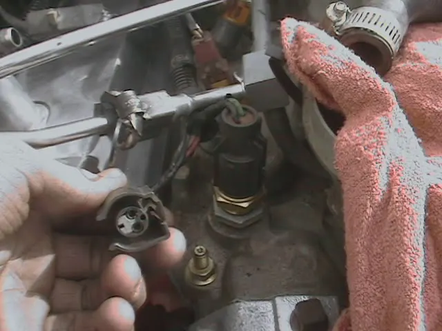

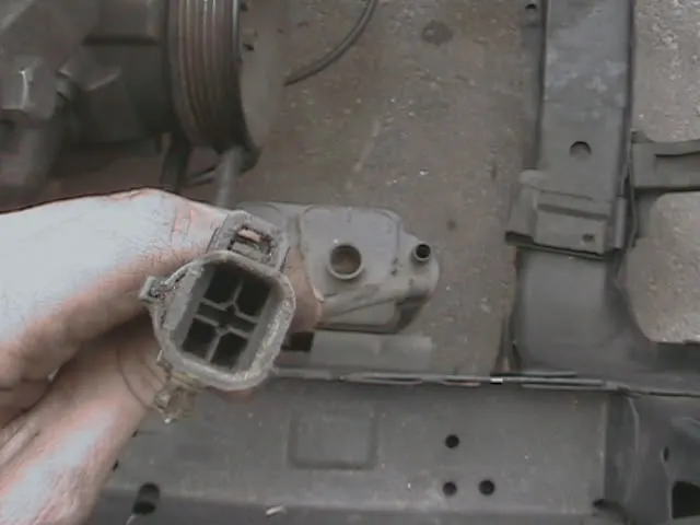

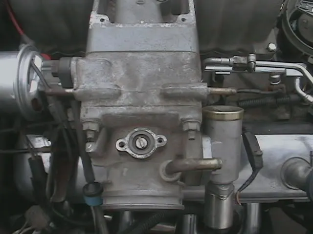

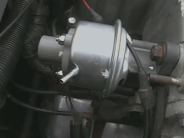

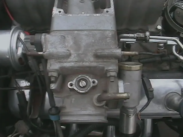

1988 302 no major mods. I am finally finishing my engine putting it in and now have no idea where any of the vaccum lines go again as i said in many threads i did not take the engine out of this car nore did i tear it down =( but i just found out today that i need a heater water suply and return tube if anyone has any pics of that it would be an awewsoem help beacause im guessing there is a connector on that i have my coolent temp sensor in the hole closest to the thermostat but there is another conector on the side of that that i have a pic of. also a wierd looking connector where i thought the passenger side o2 sensor should be but isnt also a pic of that. all of the vacum lines are torn up and broken i have a vac line map but cant make any sence of it and have been on a website i found in soem other threads if anyone has a picture or two it would be a major help! like pcv, egr, all man outlets... and so on. also is there suposed to be only one wire going to the starter and it grounds itself out through the case or did i screw that up thanks if anyone needs more pics to help or better pics or any more info just tell me ha ill help you help me i just wanna drive it ! thansk alot :bang:
all these and the ones underneath menifold
i dont know where to hook these lines up to

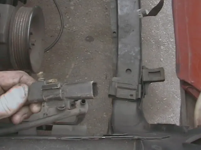

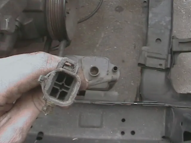

This is what is connected to the line where the driver side o2 sensor is and low oil sensor this is on passenger side no spot for o2 sensor.

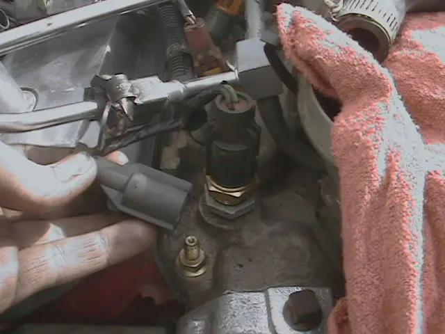

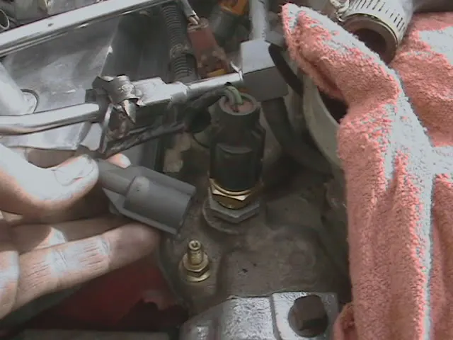

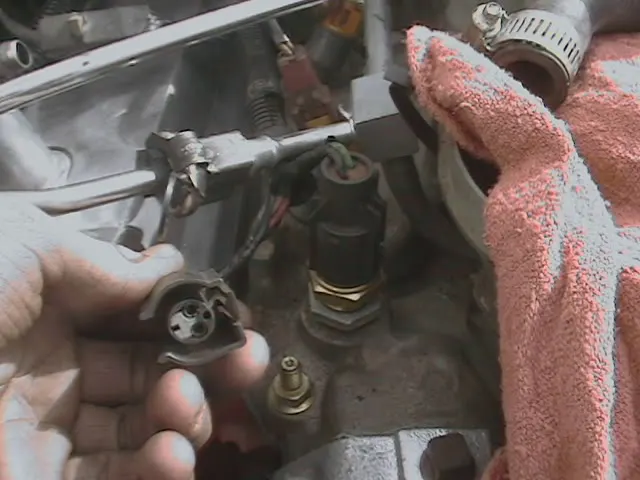

This is what is missing soemthing to connect near the coolent temp sensor near the thermostat i know this is where teh heater water suply and return tube is going when i get one

The missing heater supply tube has the water connctions for the two water cooler line in the top picture.

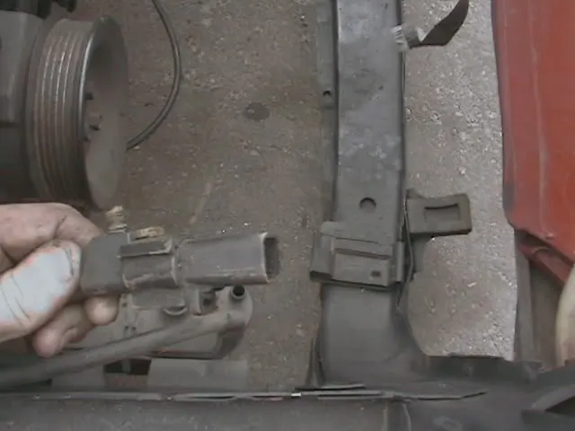

The second picture is the EGR valve. It connects to the EVR (Electronic Vacuum Regulator) on the back side of the passenger side strut tower. The EVR then connects to manifold vacuum.

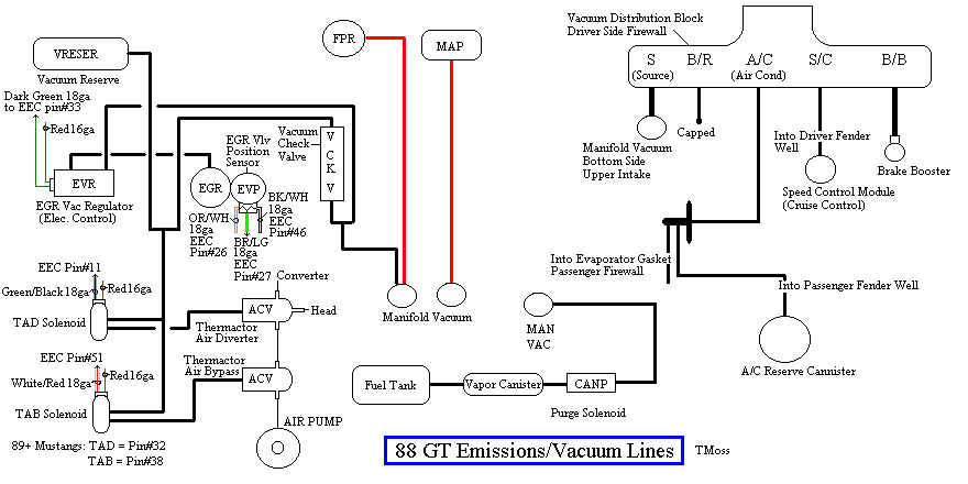

See the following website for some help from Tmoss (diagram designer) & Stang&2Birds (website host) for help on 88-95 wiring http://www.veryuseful.com/mustang/tech/engine/ Everyone should bookmark this site.
Ignition switch wiring
Vacuum diagram 89-93 Mustangs
The missing item in the picture of the ECT sensor is the Carbon Canister solenoid. It controls the vent to the fuel tank.

I also noticed in your first picture, you are missing the TPS (throttle position sensor) which mounts to the top of the throttle body, and has an electrical connector on it. You may well already know that, just thought I'd point it out.
