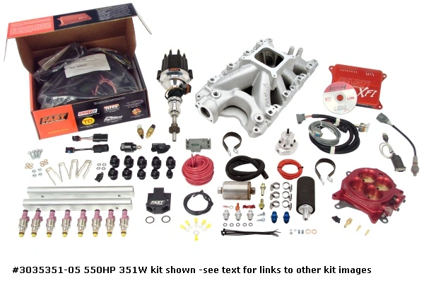

I was thinking of this.
comments??

i have the same intake and tb as pictured.
as long as it comes with enough pump & injector, and has a 2 or 3 bar map, then you're ready to go. the xfi is a good unit.
