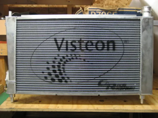

I scored this one on Ebay...I think it was made by the outfit your talking about...Visteon & CR racing...was a shop in Indy that made Nascar and Formula stuff.. Seen to many issues on the Mish's to take a chance.
Almost bought one last year the seller is now gone :(
mishimotos are notorious for leaks but the up side to that is that they know they sell crap and will send out a replacement very easily. yes the argument is i'd rather have no warranty and it work than a crappy one with a lifetime warranty. I've had my fluidyne now for easily 6 or so years now with no problems. and they have/had the same rep as mishimoto.

wow it really works.
put 2 egg's in the radiator ...it stopped leaking :)
Put in a bottle of stop leak for added measure.
Figure it a good temp fix until the new radiator and brackets come next week. Monday is SN95 Throttle body VS Fox Throttle body set up on the dyno. Going in for a retune b/c of the different ECU I have in it ( I think its rich) and b/c of the different air flow b/c of the fox swap. Even though it wont be ideal for a SN95 VS Fox comparison b/c its done a year apart at least it will give some idea of any significant power improvements.
