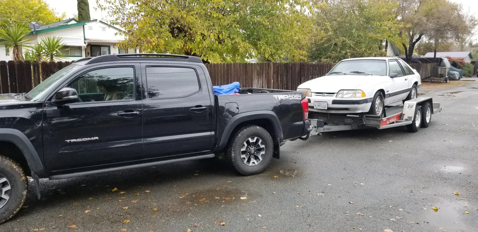

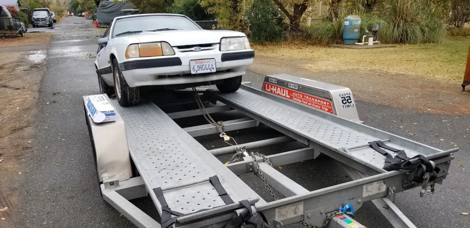

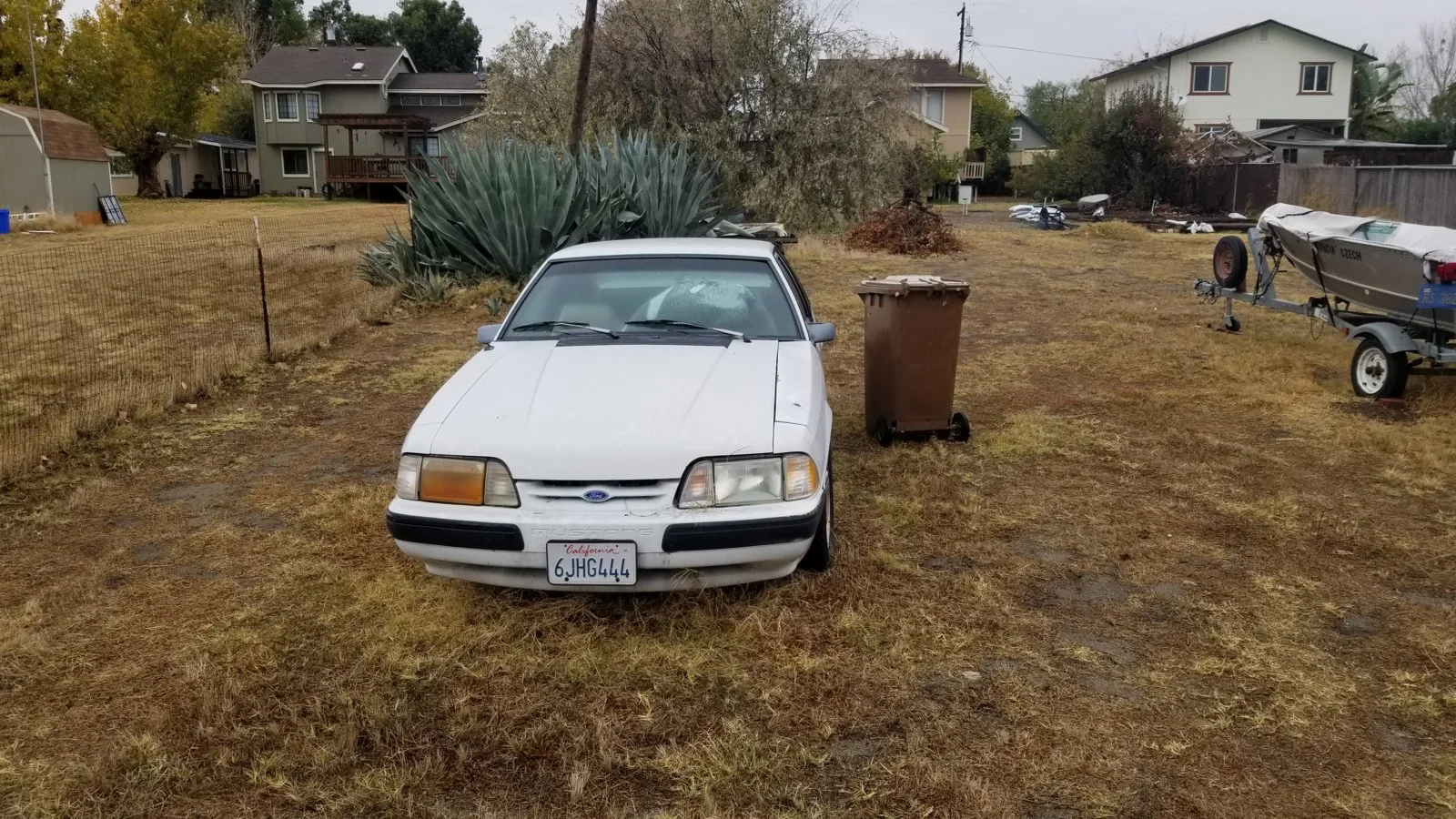

My wife recently caught the car bug when we took her Fiesta ST to an autocross event. Now she wants to race and learn to fix up cars! I'm so proud! Anyways, in order to not beat up her daily driver, she convinced her brother to give us his old 1990 Mustang LX 5.0 to turn into an autocross racer. It has been sitting still in central California for the past 6 years, but we drove down from eastern Washington to rescue it and brought it back up to work on.
Our first plan of action is to see if the engine will start. No point in doing anything to the car without a working engine, right?

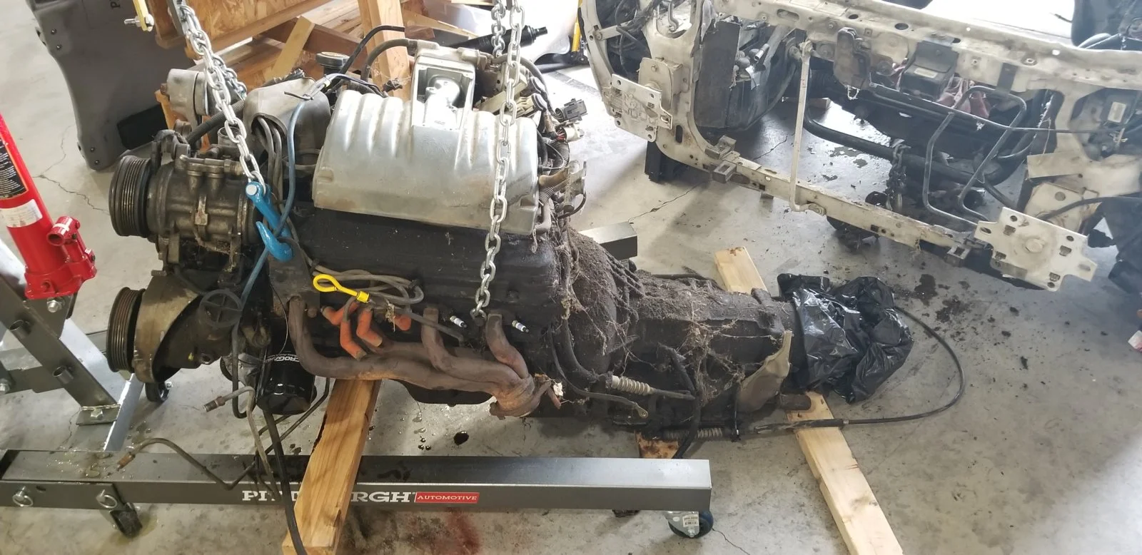

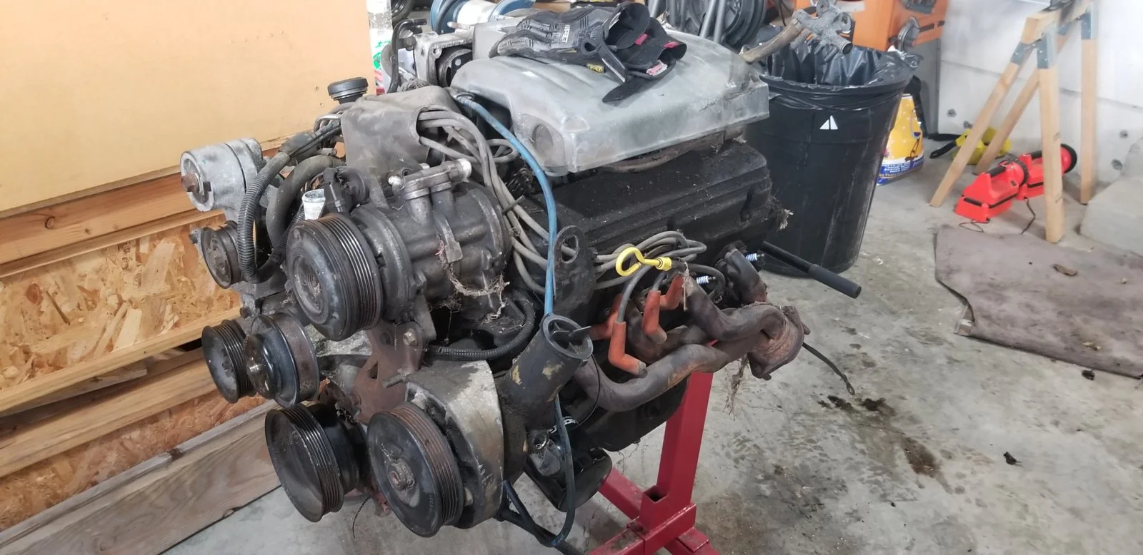

Update: we got it running with just new oil, plugs, and a battery. Now that we have proven that it works, we can tear it apart.

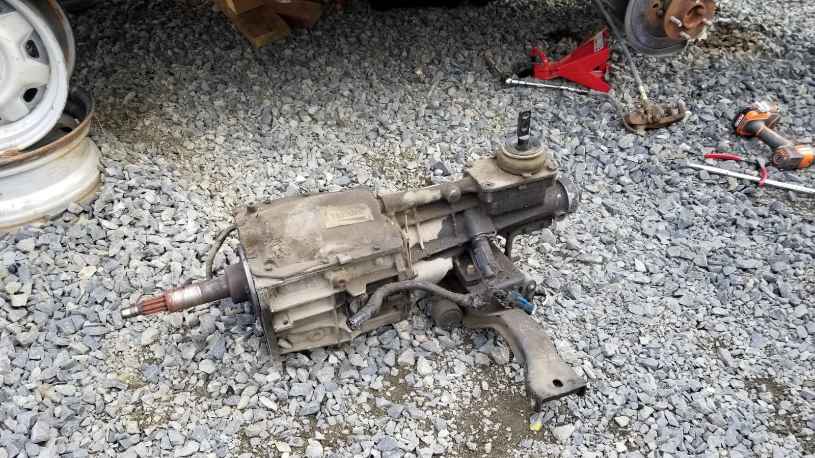

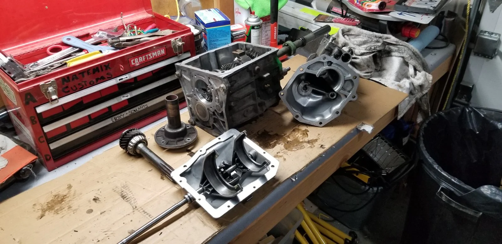

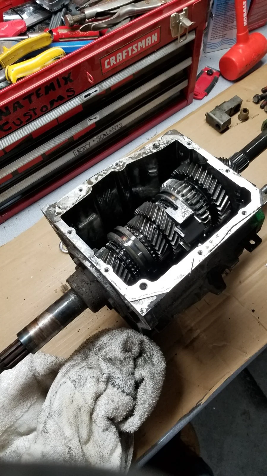

So a few things have changed with our mustang plans. The biggest thing is that we are now going to do a tranny swap. I am a bit more comfortable with it now and have scrapped a T5 WC from a 98 mustang.
I've ordered some new parts, including the proper input shaft. We will slowly acquire the proper bell, pedal assembly, and clutch as we rebuild the engine.
Engine rebuild won't be too extreme. Exhaust, intake, ignition, AC delete... basics.
However i do have a question about heads. I have learned that stock 302 heads are 60ish cc and was wondering if i can upgrade those without upgrading the cam? Would it be worth it? Reason I ask is that i want to concentrate on the handling/ breaking more than the power, but since the head gasket is blown, we might as well.
