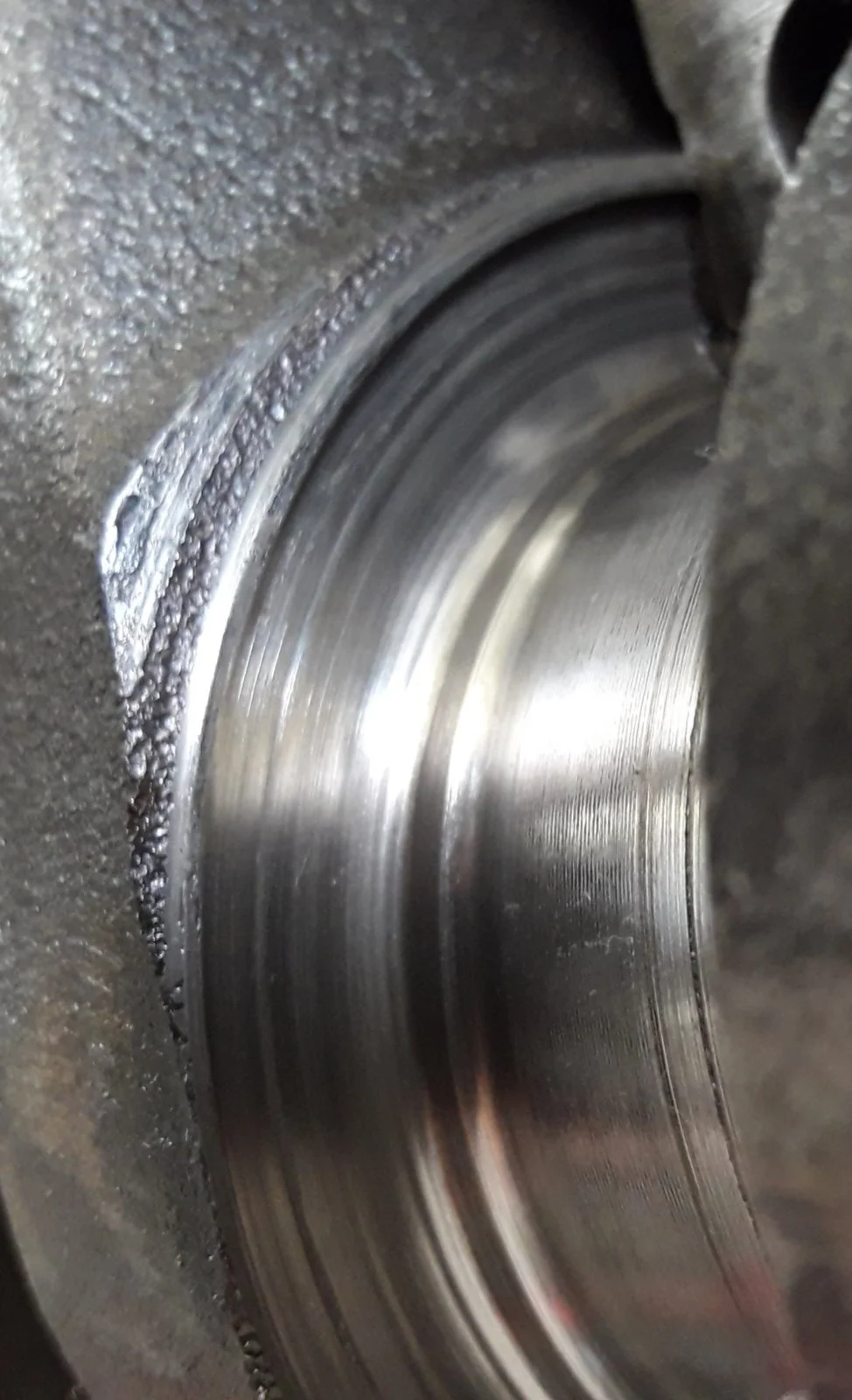

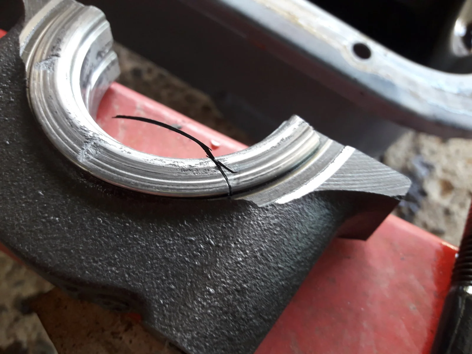

anybody with Scat Crank problems ?? her my 3000miles 331 stroker with Scat stuff ..to much damage and need a new crank with bearings.. engine builder says it comes from, stay on the Brakes and stall engine for too long. i have a 10" 2800 Stall converter with AOD ..Converter pushes crank forward and that destroys Crank and bearing .. looks like more had the same problem .. ""common problem when there is too much pressure in the trans pump, not enough converter clearance or sitting on the break too long and loading the crank."" converter clearance not possible there is a lot...
