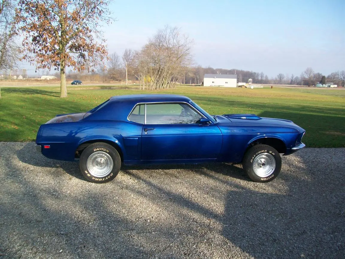

I got a 1969 coupe with a new crate moter not installed needed a new int and lots of body work off E bay just pictures is all i saw of it and i payed 6.000 for it
