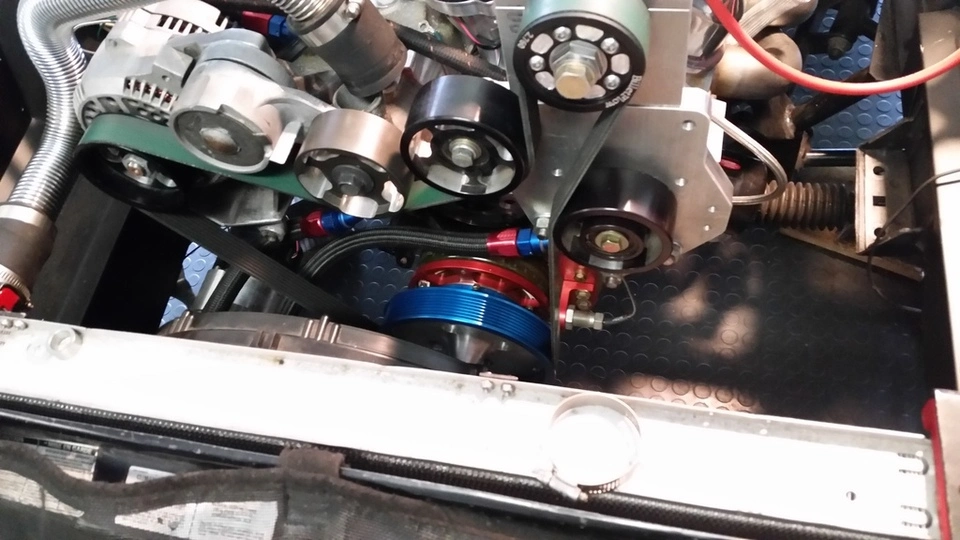

The following picture is the best one I have of the serpentine belt going around the crank pulley. As you can see the belt wrap is not optimal. I will definitely need to address that issue. Don't know why it passed muster when everything was being put together. Possibly due to 978 other things needing attention at the same time Lol.
I am no blower specialist.. but that looks to me like 50% belt wrap if not a little better. Is the seriously not optimal? I understand the more contact the better, but geez. I guess you could fight belt slippage with a blower, or the plethora or problems with a turbo..

Thanks. It is speculation at this time. I am thinking it needs more belt wrap. The blower should be putting out about 20+ psi. I see a peak of 17 psi. Is the 17 psi reading the result of belt slip, or is the engine just using more of the air that the blower is producing so I am not seeing the higher boost number that we see on my friends car with the same blower? I don't see a lot of belt dust usually caused by slippage, and the car is quicker and faster than my friends car, so it is producing the HP that he sees with a 20 psi reading. There are a lot of things that could be causing the discrepancy.
