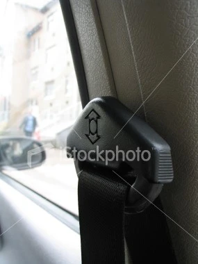

I had my car at the dealer for a few things and figured I would have them look at the seatbelt since most of the time I have to manually retract it back into place when taking it off. It turns out there is a TSB on it and they replaced the rings that attach to the post where the seatbelt goes into the car.
See the black ring/loop that the seatbelt goes through?
The new ones have a plastic coating on them that makes it real smooth and so far it works great.

2001 Geee T: Is that picture the actual seat belt loop on your Mustang or just an generic pic?

iStang- that is just a generic pic I found.

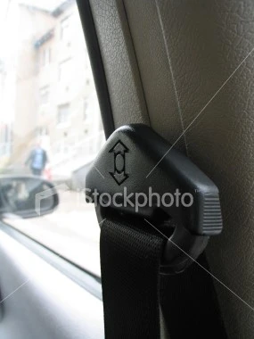

Here is the part number I have off of the invoice.
FMC YR3Z 63611D70AA
This is what it looks like. Notice the white plasic wrap around piece.
This is what I thought they replaced at first when they said seatbelt ring.
It still works like a dream too!
Its not tape. Its a smooth plastic piece that goes over the original part. Actually its a whole new part. It may look like a cheap fix but it works great. It makes me want to take my seatbelt on and off twice each time I get in the car. :D
