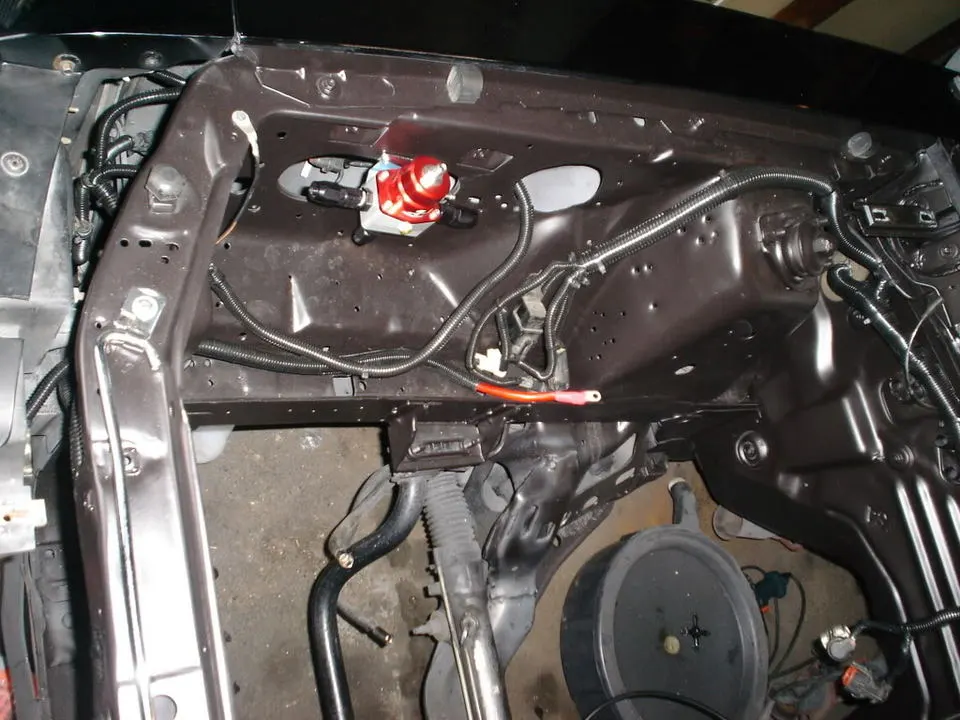

look at the passenger side frame rail right above my k member i did the same fix,its easy. i cut out the old crap with a cutting wheel, sandblasted the piss out of it,welded a plate in and then welded a plate over it for more strenth.my equal length shorty mac headers i had at the time wiped out the frame rail.
ok....the car is extremely solid all the way around. this is the only real spot. a little surface stuff in the rear but a lil blasting and paint will bring it back. its going under the knife in the few weeks when i store it, so im just getting all my peas in one pod. just got a turbo kits waiting for me and im accruing the cash, and the rest of the car is one payment away from being one heck of a car next summer.
thx for the pics 408, thats a real clean repair. what did you use for the patch panel?
