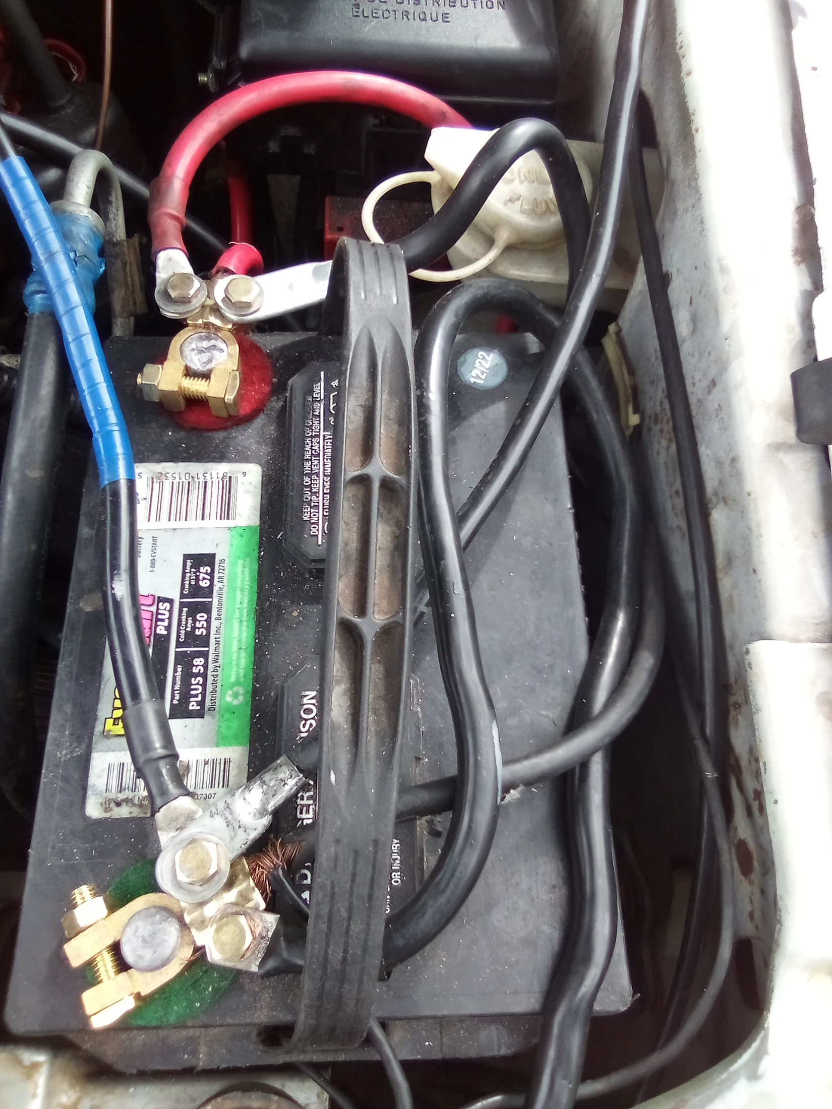

Fixed...Electric problem, battery cable touched ground
It's Walmart battery. It's about year old, didn't do too well on 100 amp load test. It's dropped down to 11.3 volt. I think it should be little higher then that.
The wiring on your battery is less than ideal. You may want to consider putting ring terminals on the two cables that have copper wire exposed and then heat shrink them. Run a set of these battery terminals if the existing battery does not have side posts.
Ditch the wing nuts for a flat washer and regular hex nut.
I really appreciate your suggestion. Temporary I repositioned the wires where it's getting a lot more surface connection area. Car feels a lot better, still pings from time to time. Yesterday after getting engine up to 3k rpms many many l times while driving seems to stop pinging. It's like getting every last bit of changing into battery seems to help. I wonder how bad this light pinging is it for the rings and bearing?
It's not loud knock. But very distinct tap tap sound right around 2000rpm to 2300rpm..
What kind of compression does the motor have? Where is the base timing set at and how did you go about setting the timing? What octane fuel are you running?
