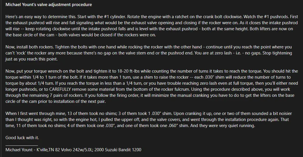

Here's the method I followed in case it can help anyone in the future
(you can go to TDC and do 1/4 turns on the crank bolt as you go to each cylinder in the firing order instead of watching the pushrods level out)

Here's the trick that finally got the car right:
"With a proper length pushrod, the rocker will have side to side play but should have none up and down" (on the top of the pushrod)
I had many rockers that felt wildly loose side to side but had literally nothing on the tip where it met the pushrod. It sure felt like it would cause a rattle but I trusted the science and once the car started it ran smooth and quiet.
