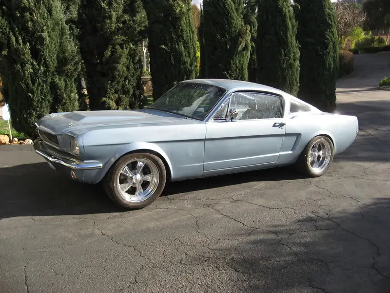

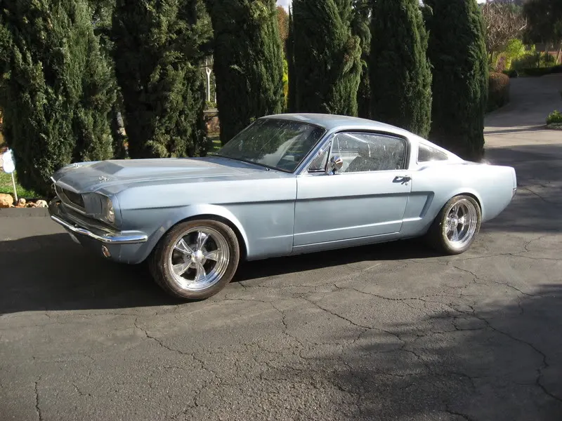

Actually they used '67 inner wheel well panels and stretched the stock '65 quarter panels over them. I think it yielded about an inch and remained very stock looking. I'll see if I can find the thread and post a link later.
Tim

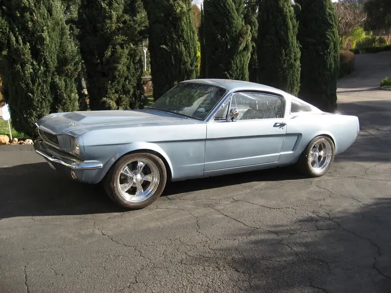

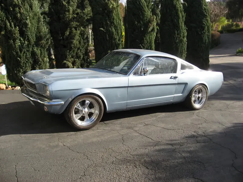

That was me. Here's the thread about using the 67/68 outer wheel housings to push out the stock 65 quarter panels.
http://forums.stangnet.com/showthread.php?t=677887
Here's a side by side comparison:
This was quite a bit of work and wouldn't recommend it unless you were already replacing the quarter panels.
I think it gave me about 1.5" extra on each side.
Here' a shot of the finished product. You really can't tell that it isn't stock unless you have a stock car next to it.

Mustbereel,
Thanks for posting. Your car is looking great and love your quarter panel mod!
What size tires can you fit in the rear?
Tim
I have 275/40/17 on 17x9.5" rims. There is room on the inside for a larger tire but the foward strut of the Heidt's IRS gets in the way. I could have ordered the IRS with a narrower track width but didn't realize at the time that it would be necessary. I probably could have gained another inch on each side.
Now that's what I'm talking about! Very cool!

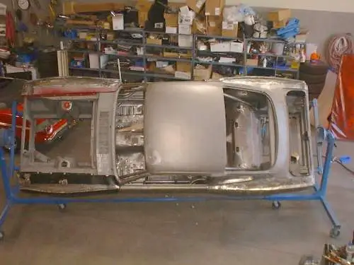

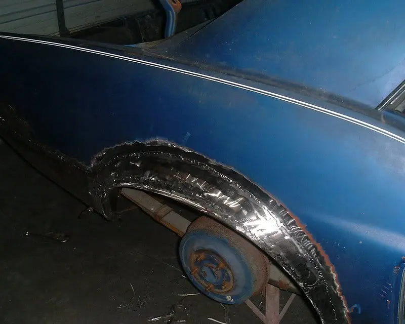

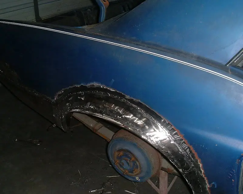

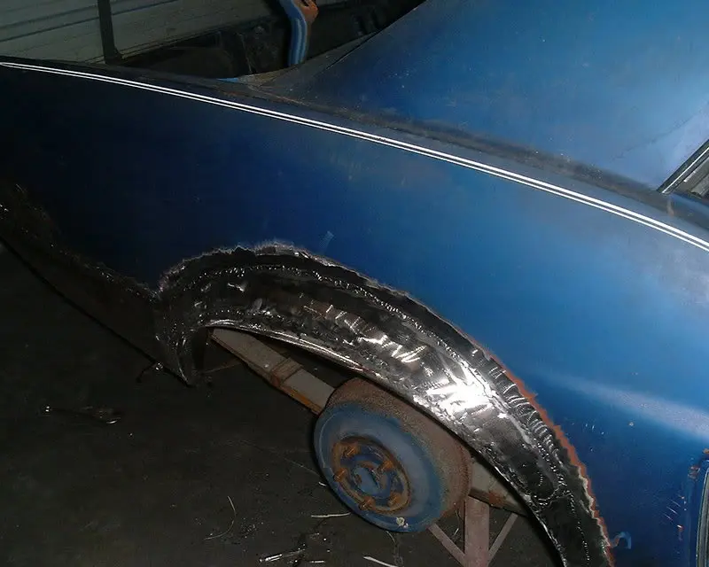

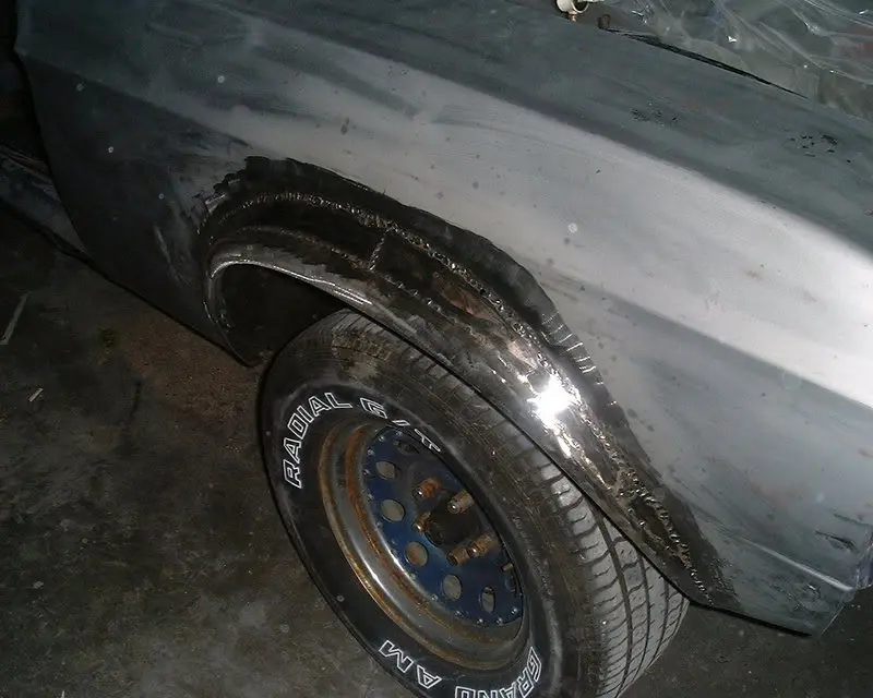

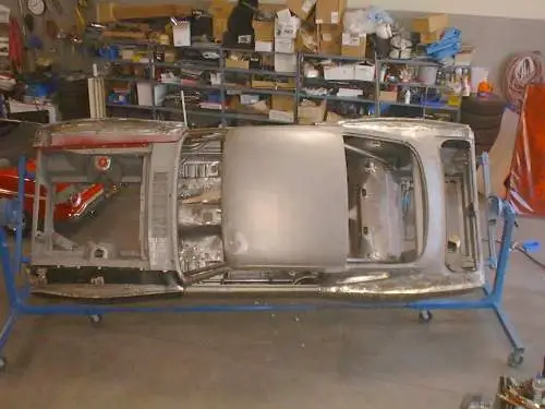

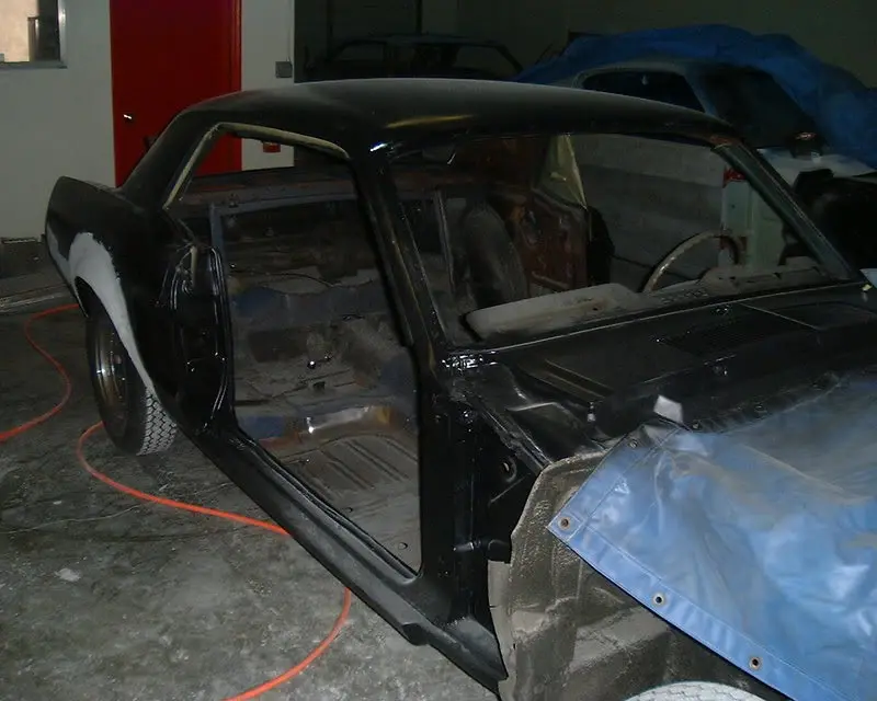

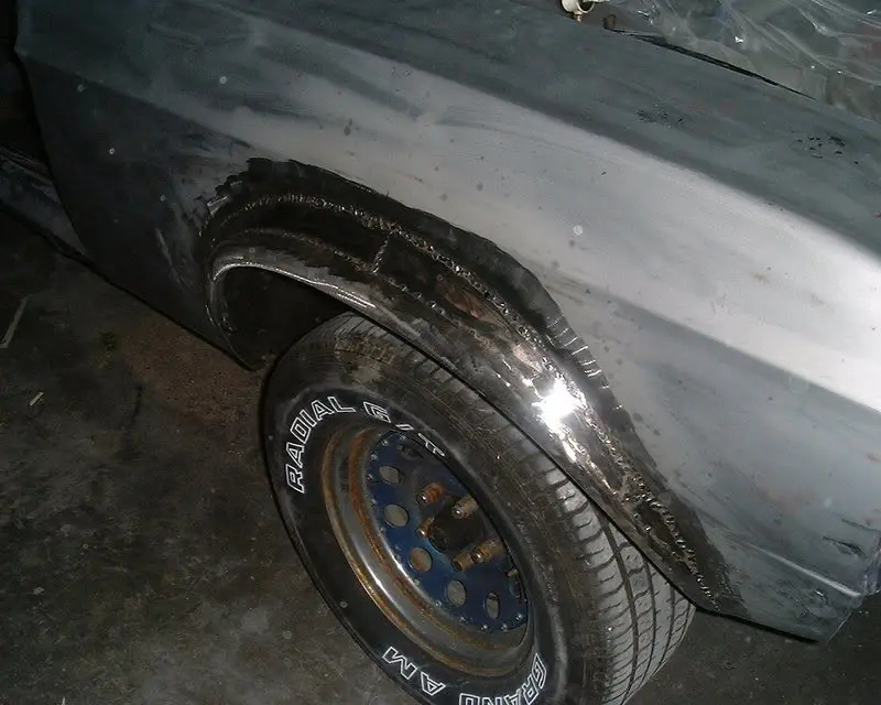

I'm building a 68 coupe and flared the fenders about 1 1/4" and the quarters. The fenders are alot easier. I used a cutoff wheel and cut the fender in the middle of the flare but left it attached at the bottom about 1/4" - 1/2" Spread it out the distance I wanted and welded in a patch. Did the same on the rear except you also have to cut the wheel house and patch that first and than the outter quarter.
I really like this idea and am tempted to try it on my 67. It just looks like an awful amount of grinding.

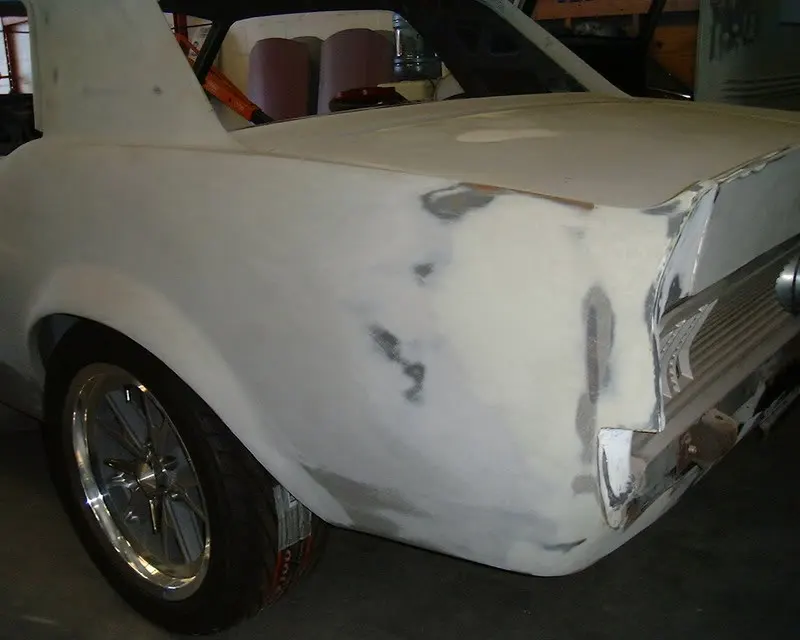

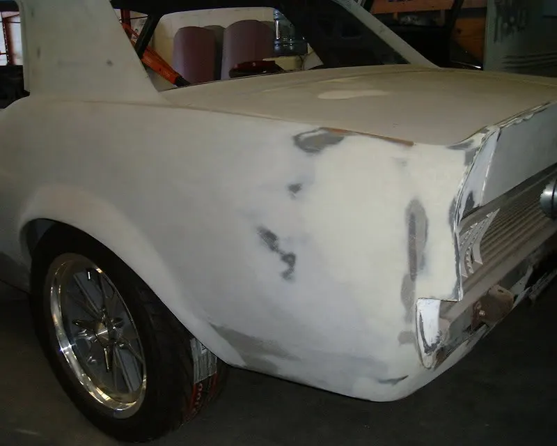

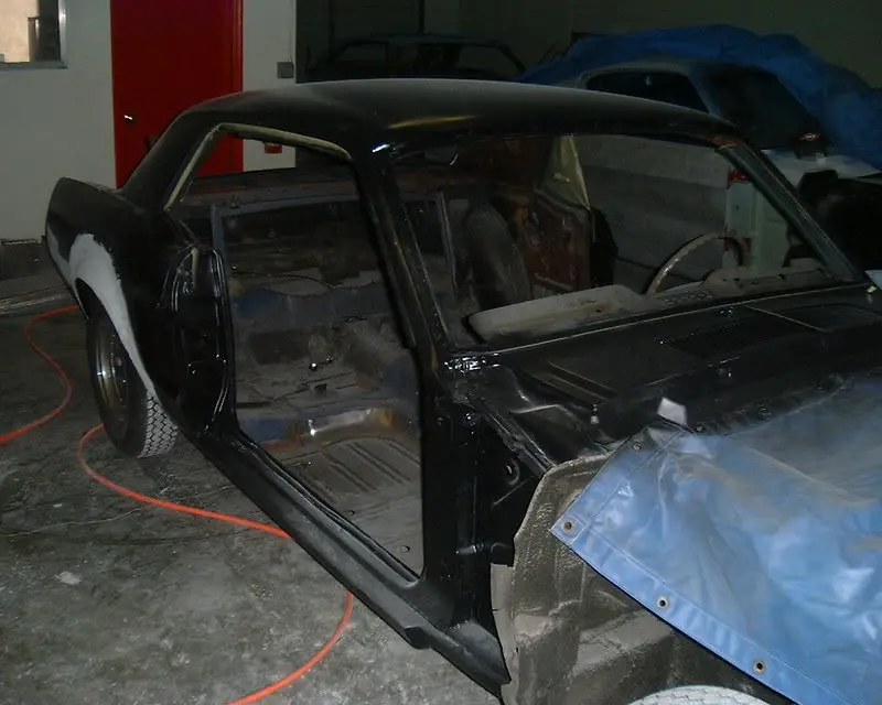

I did mine only it's a'67
It took a long long time to get it right. I think there are afew pics of the process on this site.
I would not recommend it to the faint of heart. I moved the inner wheel houses in an inch and cleared the front portion of the inner wheelhouse, which usually angles back towards the tire. Instead now the wheelhouse is even all the way around.
I widened the outer wheelhouse and moved the quarter out (stretching it) this was about all I could do unless I performed surgery with a cutter.
There's some pics with a 17 x 11" rim I tested a few weeks back. I can fit a 315-35-17 or 295-30-18 no problem, now.
