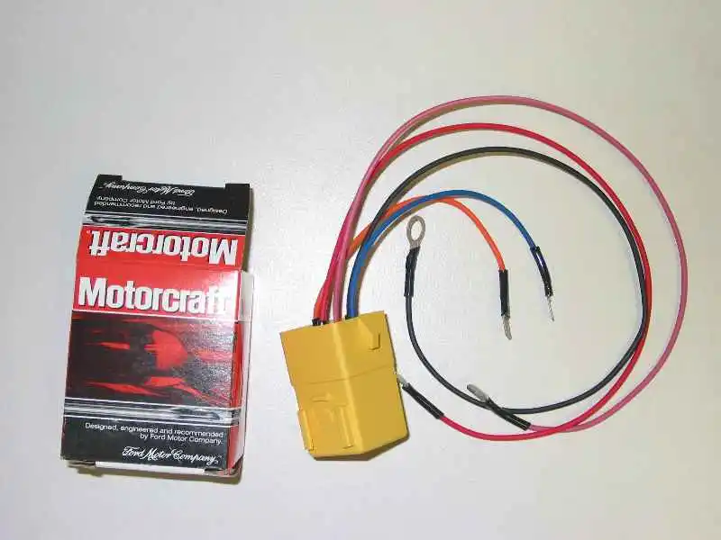

Found it. It's off an '03 and it is yellow. Part # F67B-13350-AA
Other numbers on it are:
71469
H252
3 (6) X 32CP-12v
DOT/SAE TBB89
Hope this helps. :D
It looks like this minus the wires, cause it should plug right in.
