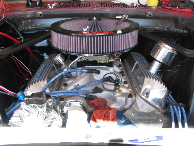

As far as the sensor is concerned, if you have one of those that wedge in between the fins of the radiator...throw it away. Even if they work when new they'll fail to work well over time. They'll get loose or get dirty or corrode and make a bad (thermo) connection eventually.
I got one that threads into the coolant jacket of the manifold, don't remember the part number but it was off a Taurus 1988-92 I think. Brass fitting, sealed wires, hooked right up and activates at 160-170 degrees.
Edit: I found a picture with it visible, not a great one but you can get the feeling of what I tried to describe...
