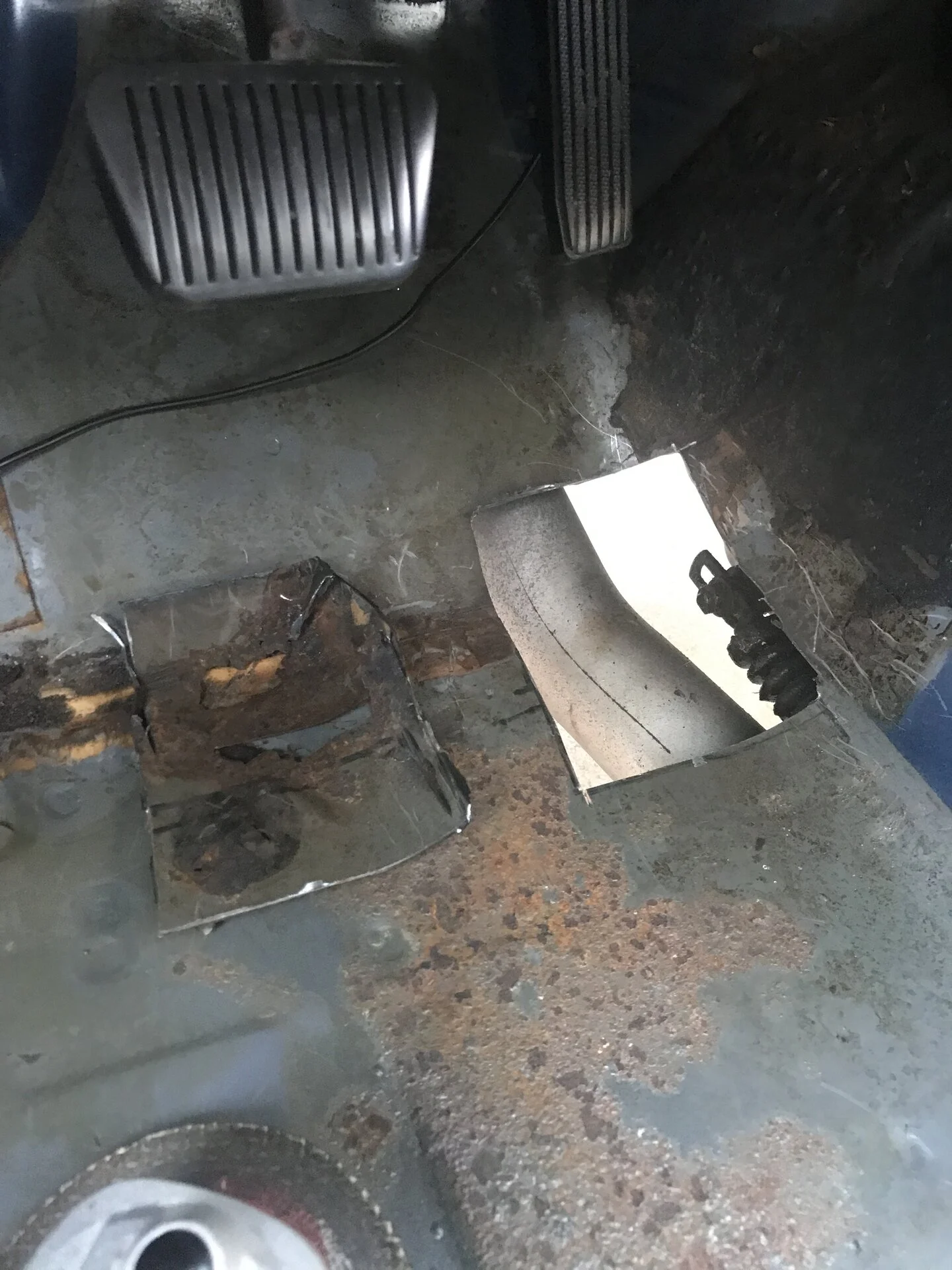

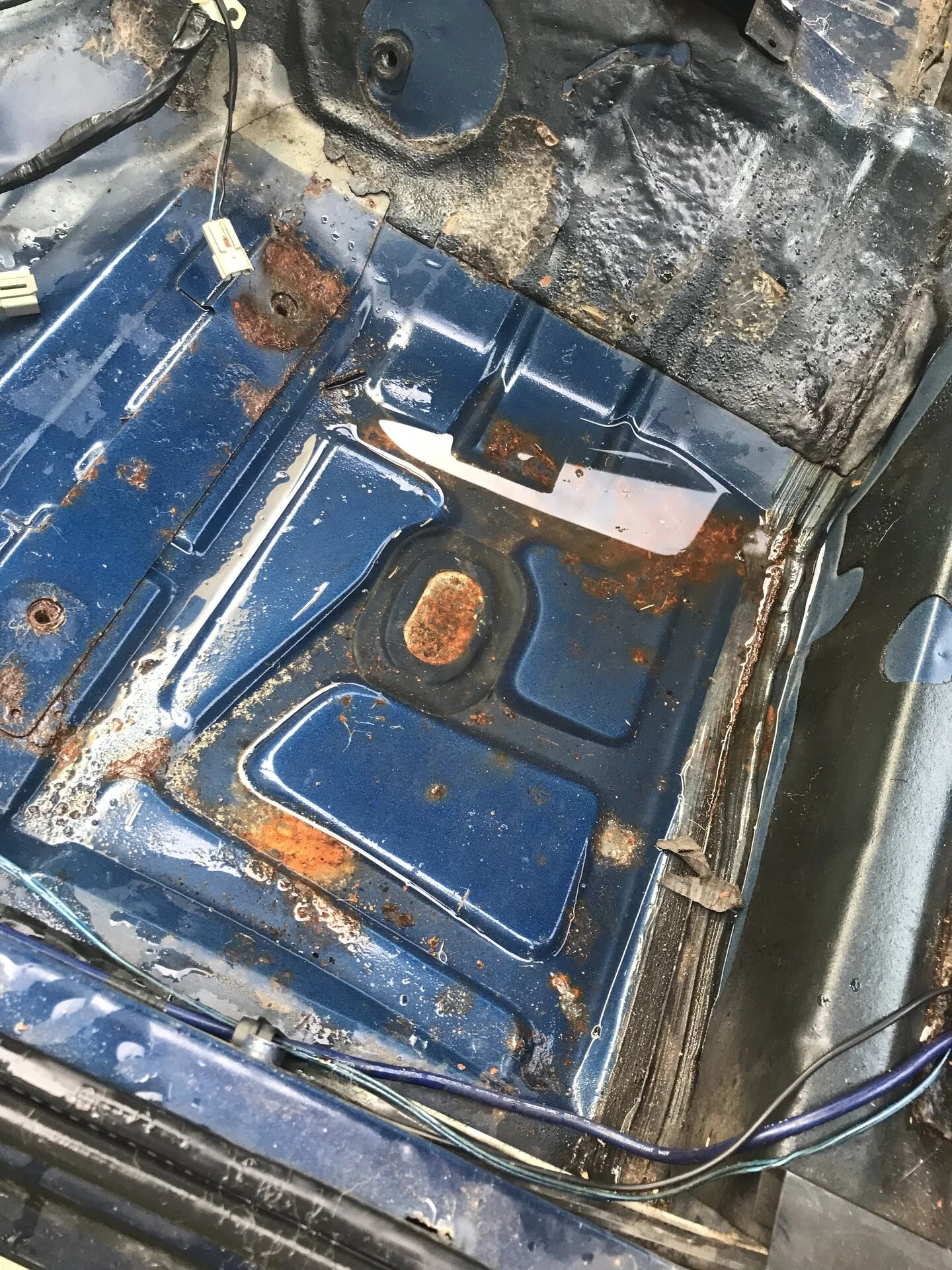

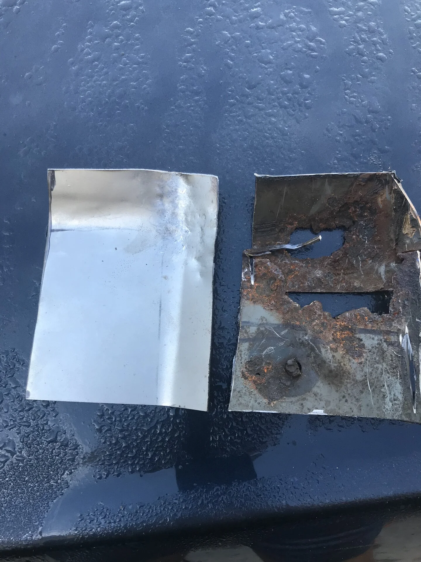

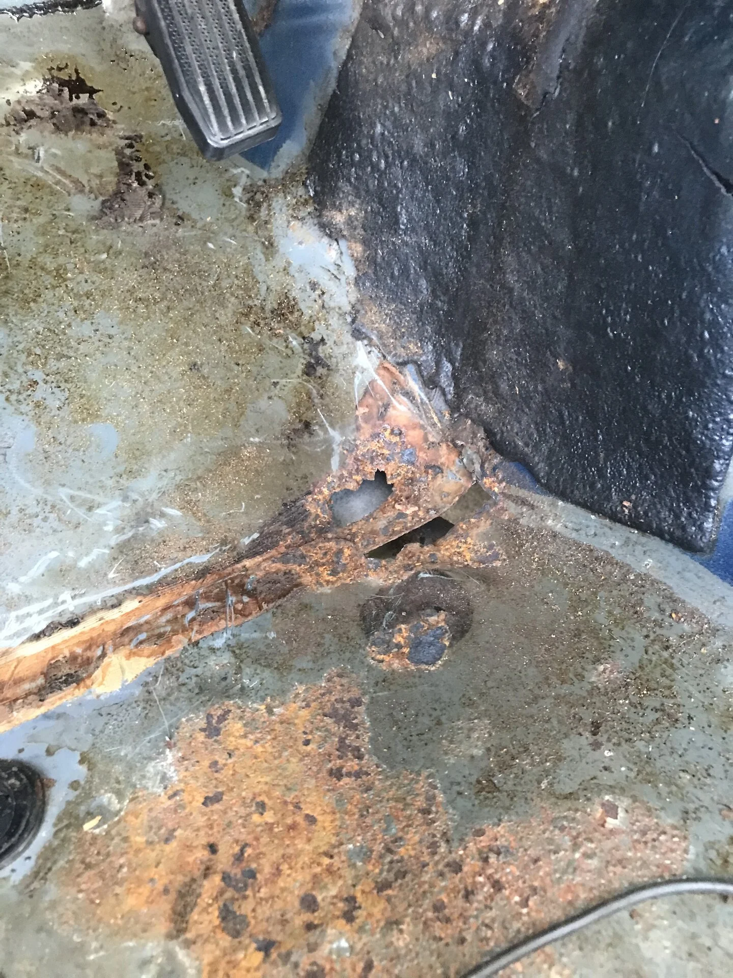

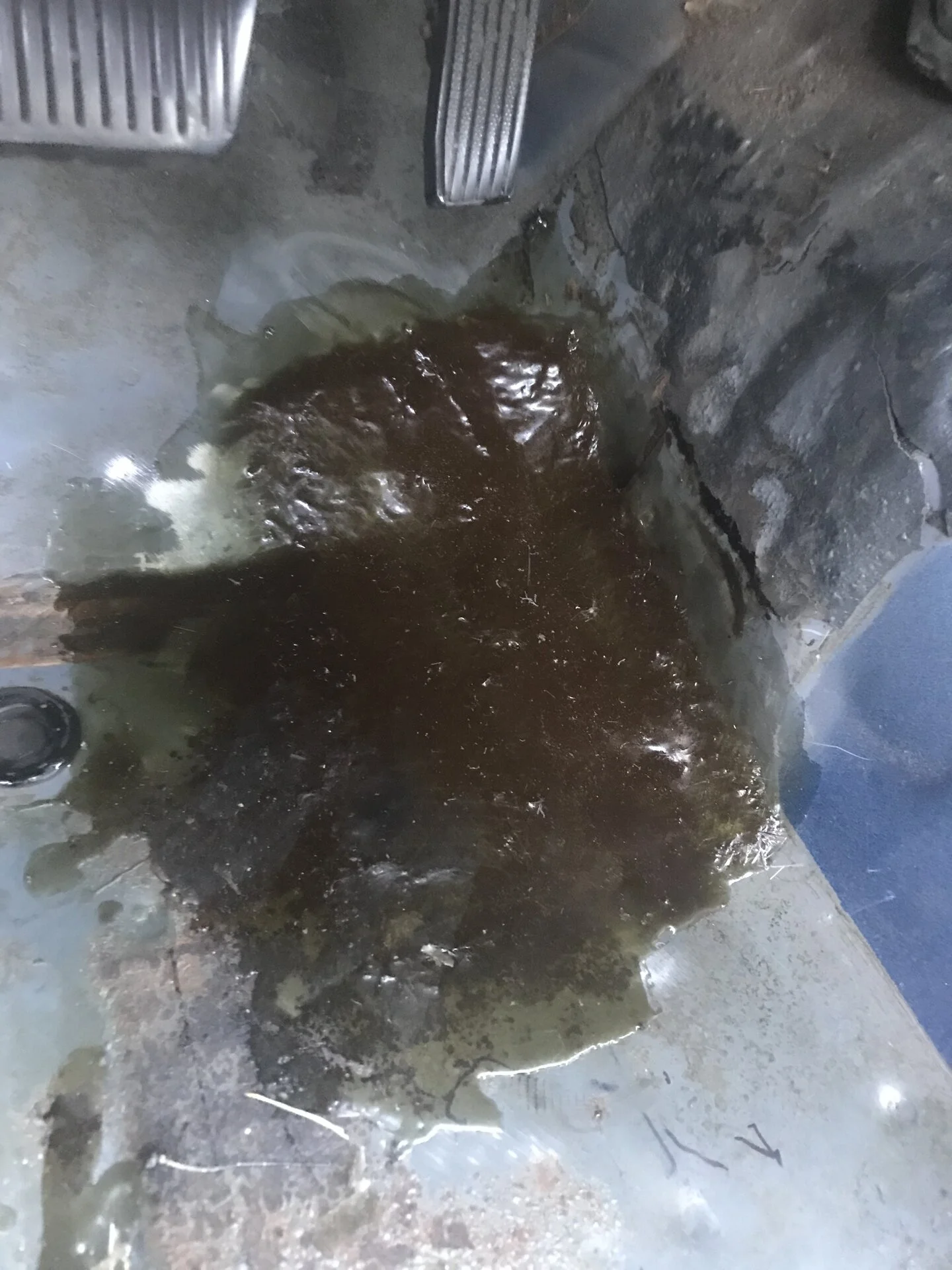

Finally took out the old carpet which I discovered it was totally soaked on drivers side after the constant rain we’ve been having here in Tampa. I only found one hole so I got lucky . There’s water draining from under the dash on the far left side. I took off the cowl cover and vacuumed it out and poured water in however it didn’t go inside. Last night it downpoured pretty heavily and it drained in from that corner so I’m guessing it is the windshield area under the trim.

Up here the cars rust from the bottom up. Down there everyone says they rust from the top down. These cars are getting old and rust is really common now.
Up here in the Northeast, I think they rust from the top down, AND the bottom up. Luckily most of the survivors these days are kept in the garage.

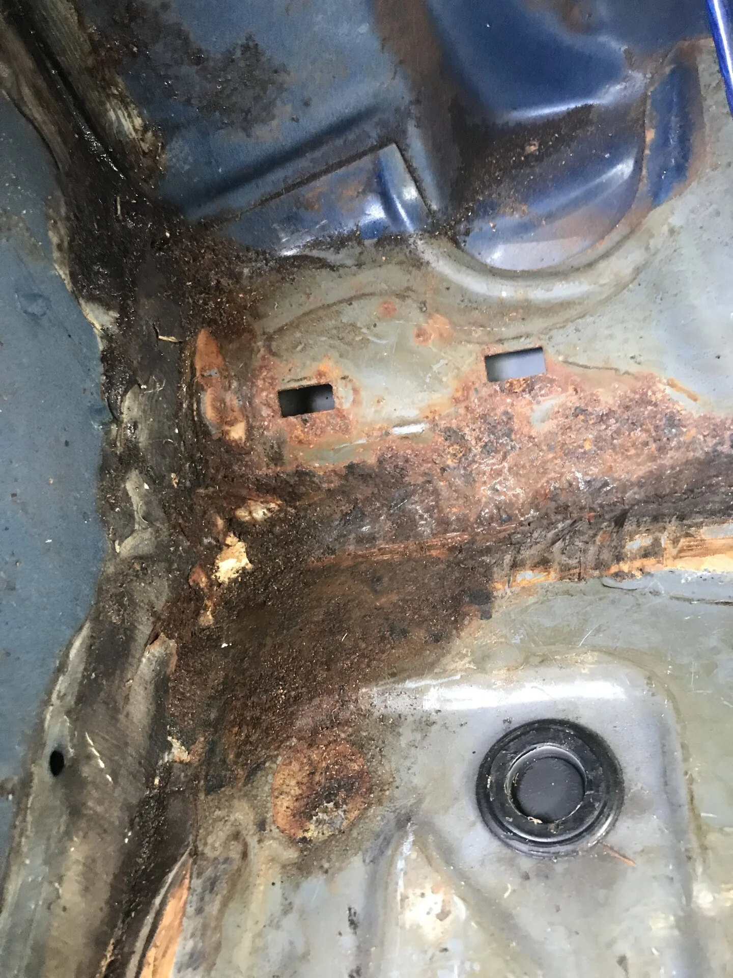

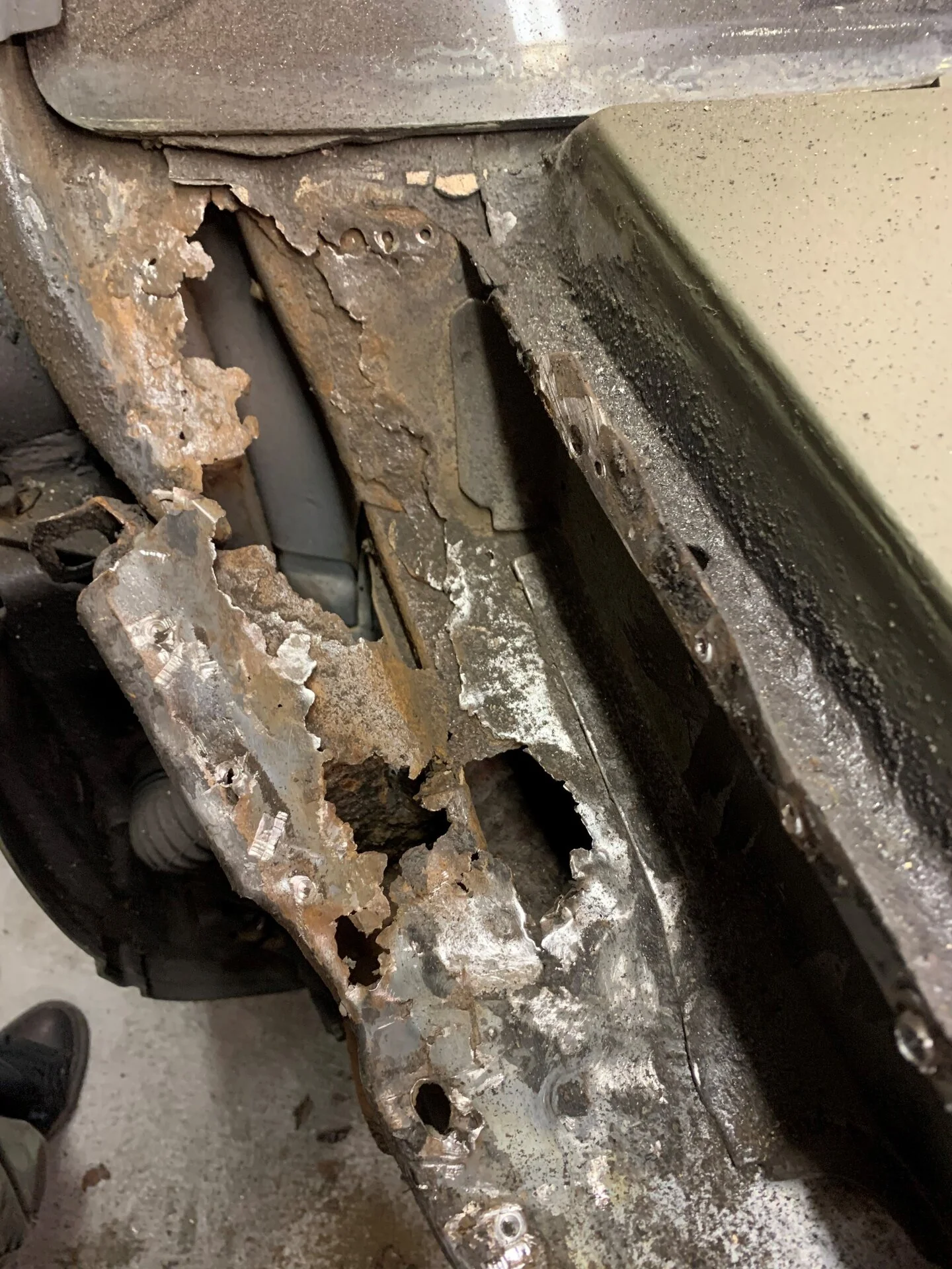

My car was originally a Florida car I found heavy rot on the side of the cowl panel over the door hinge. Upon research at the time i found all cars were from down south rot in that area. Attached is a pic of what I found after cutting and removing some of the panel to the side of the cowl.
oh that's funny, mine had a rust hole on the driver's side in the same area and it's a Florida car. sorta glad I'm not the only one.

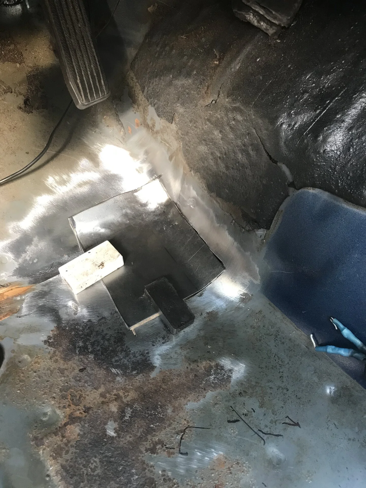

Well my welder was a bit hot even when turned down so I ended up stitch welding the patch into place with some burn holes. I had some 1808 fiberglass and used two layers to cover it up. Probably stronger than before
