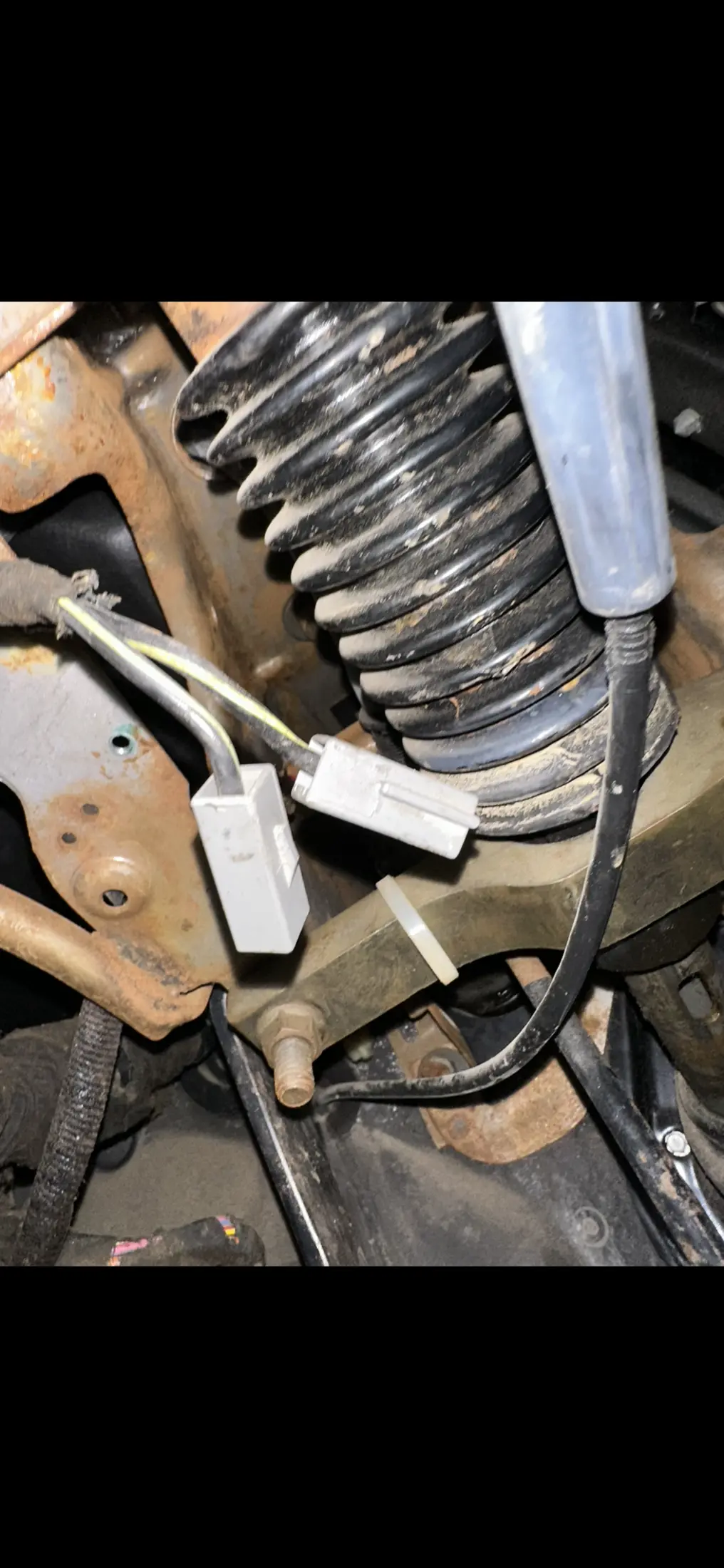

Anyone got an id on these two wires? They’re connected to the huge dash harness. I’m assuming they’re some sort of test plugs?

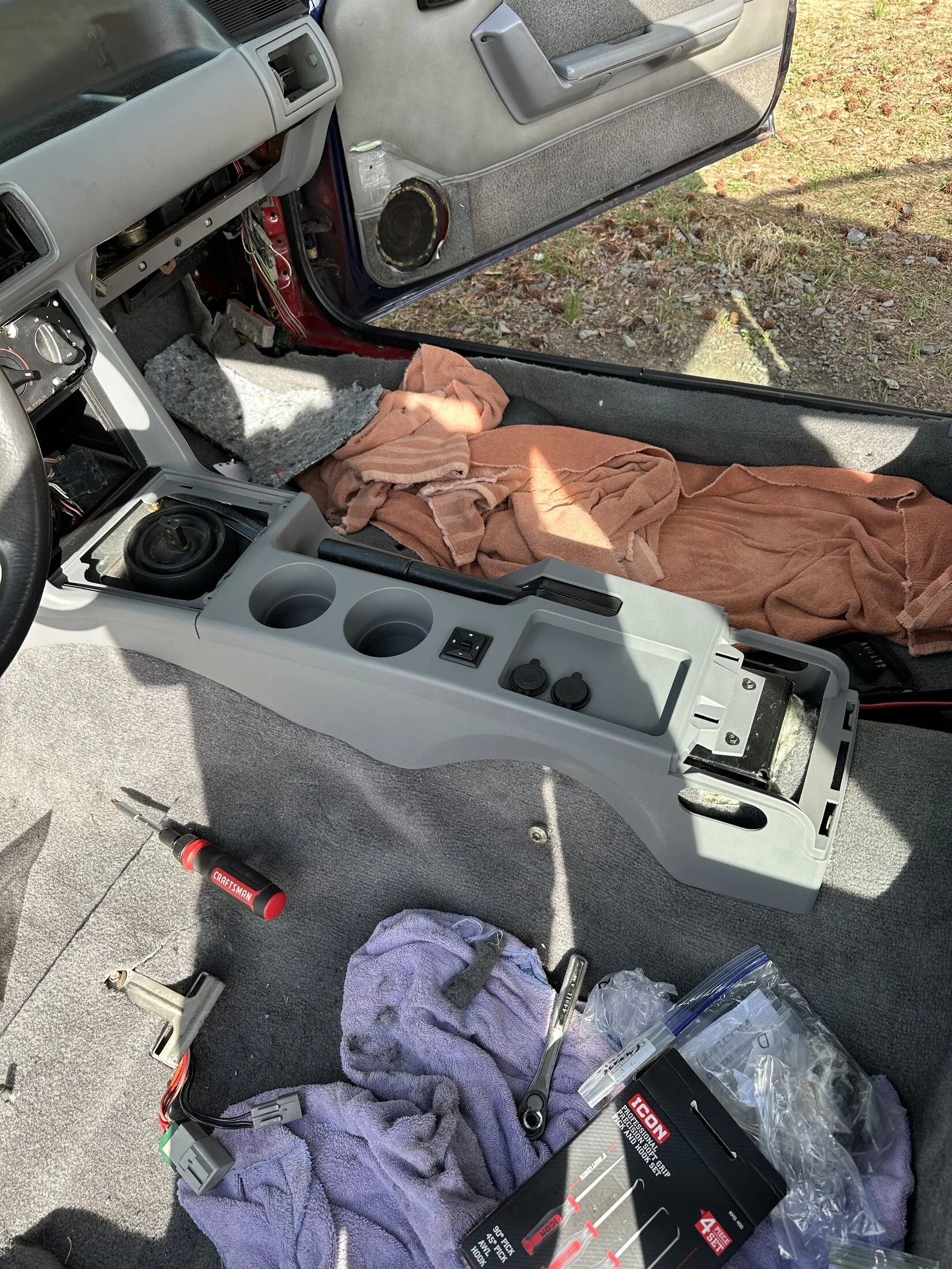

So a small update
Got the center console in and the cup holder console. I also took the car for a test drive and it was underwhelming but the clutch does engage and disengage even with the wacky cable situation.

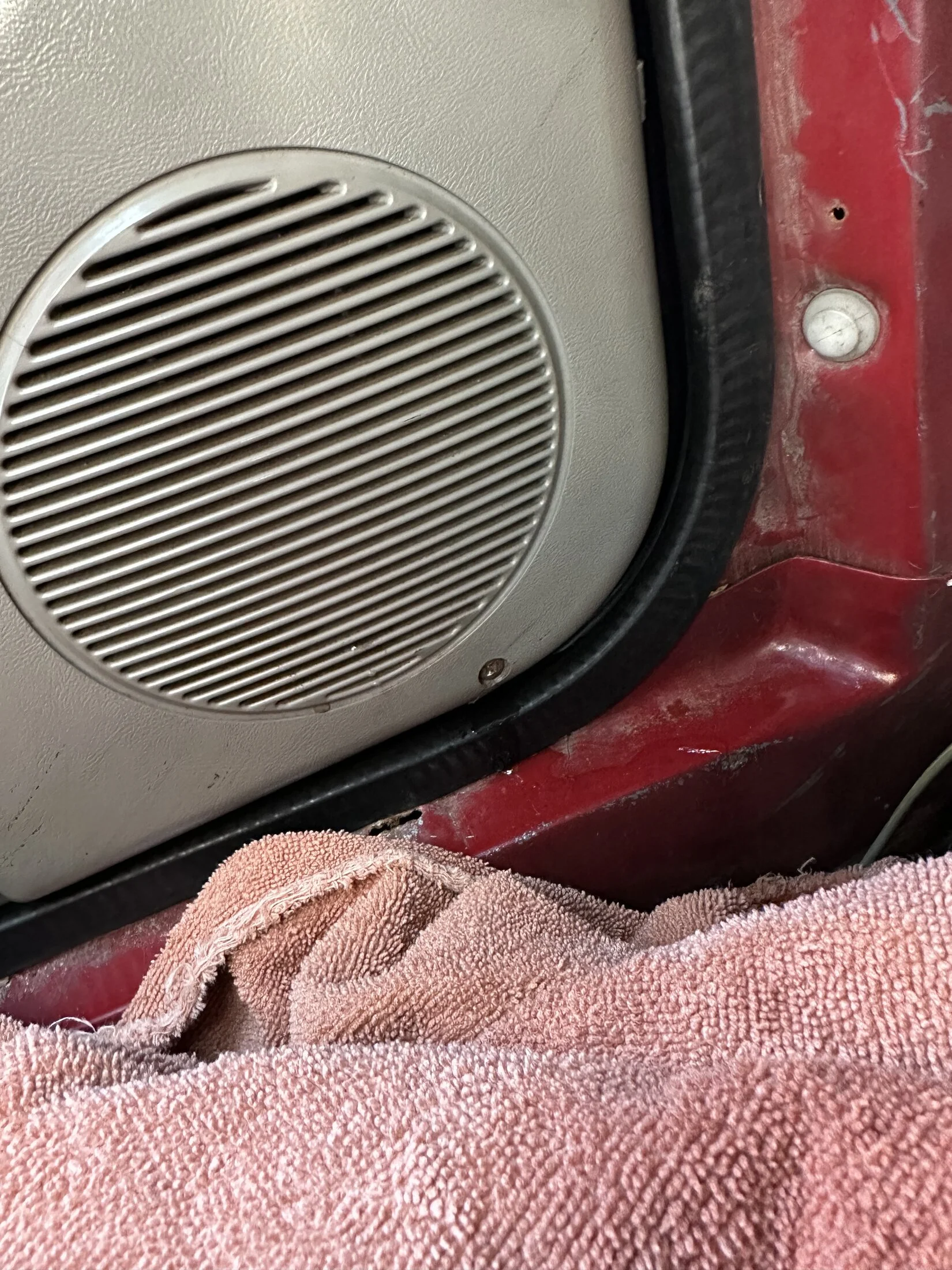

I also got the quarter horse configured and installed and it runs so that’s good news. I need new weatherstripping on the drivers side because after a big rain I found my drivers side floor wet and when doing some testing I found this
It always seems to be something. Things have definitely slowed down since my new job started but I’ll update once the full interior is back together and that will be the end of this progress thread. I’m sure I’ll start another one soon enough about something else though
