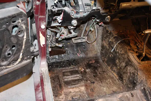

The driver toeboard will probably require everything to be replaced. The pass. side I could probably do a patch on.
Darn, was hoping i had a fellow mustang enthusiast nearby to help me when i needed another hand or two! But glad to see you got out while the getting was good! Anyway...the drivers is probably the harder of the two to replace, you got the steering column, ebrake cable hole, etc....How about your torque box? does it look like it needs replacing? Easy to do while you are already in there...
This shows a bit of what I have to deal with. The hole crack actually goes all the way to the floor dimmer switch. I think I can cut below the steering column and all the other holes in the firewall. I'm still a bit nervous about getting it in and out.
