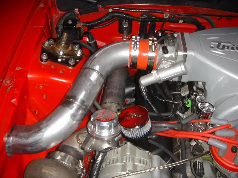

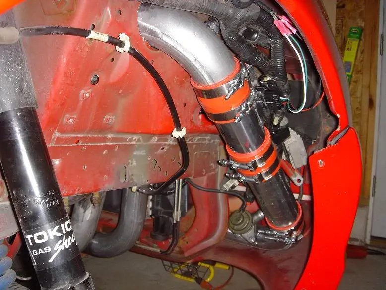

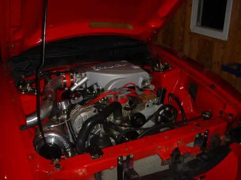

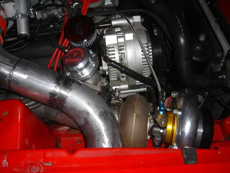

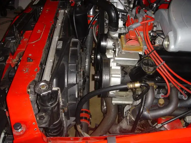

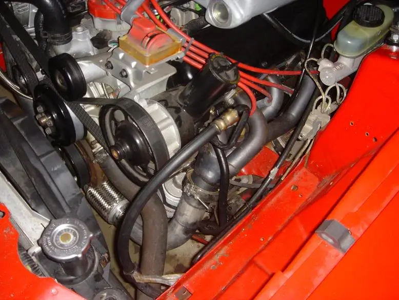

Now for the good news. Everything came out awesome and looking better than I could have imagined. See for yourself:

What are you gonna do for a finish on the piping? Ceramic coating or paint?
once again, looks awesome, can't say it enough
I am paintin just about all of it. I think I'm going black on the hotside and silver metalic on the cold side.
