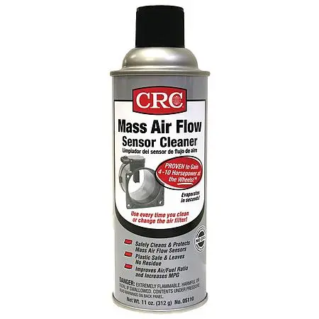

You're running a K&N filter, presumably oiled. Have you ever cleaned the MAF sensor?
If not: The oil from the filter can get on the sensing elements of the MAF leading to it under-reporting the amount of air entering the engine. When running oiled filters then, the MAF should be cleaned periodically. Get a can of real Mass Air Sensor cleaner, for example:
and give the MAF a good cleaning.
Sorry for the tardy follow up, been gone. I just wanted to thank you for the advice on he Mass Air Sensor. I got that cleaned, and the car worked like a champ, all the knocking just disappeared!
Thanks again!
