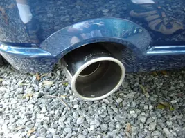

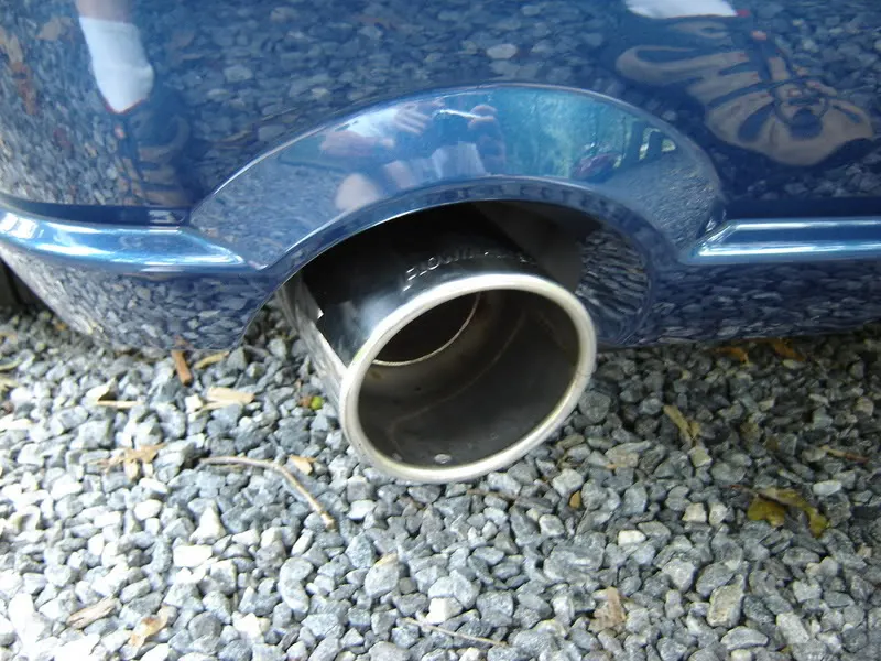

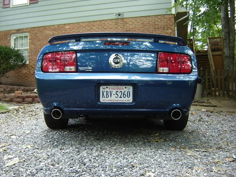

Mine are pretty near perfect on the alignment and I have never had mine hit the frame rails.

If you have not figured it out based on what the fellas have said (loosen isolator and hanger bracket bolts and move as needed to center LH/RH) or this has not helped, PM me and I will send the exploded view PDFs on the exhaust and bumper, the alignment may be spot on the exhaust, the issue may be the bumper alignment. Seems odd, God knows, but my bumper got jacked out of alignment after "they" performed the fuel tank TSB. :shrug:
