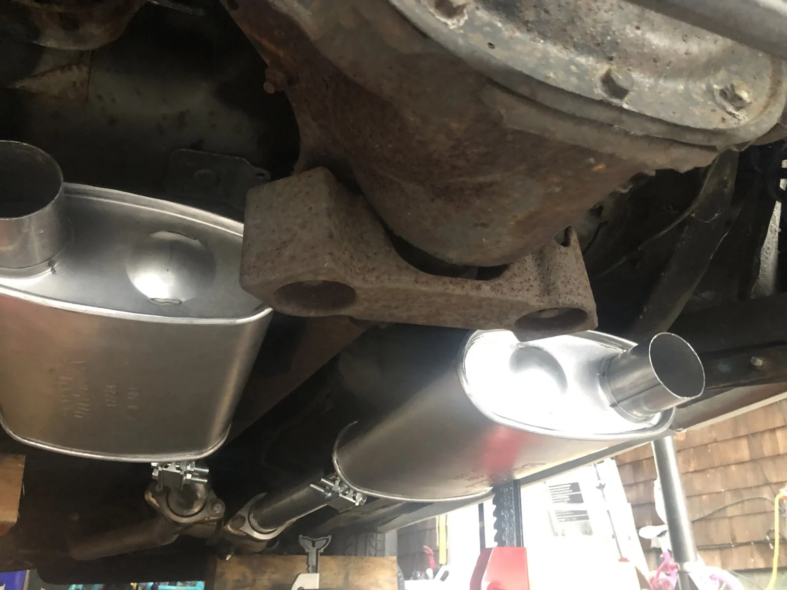

Super Turbos are in. They sound awesome. Significantly quieter but still with a nice deep tone and the cam lope still comes through. They are much heavier than the flowmasters and do not have hangers welded onto them so currently the mufflers are scraping the ground. After work today I will be throwing on the tailpipes I cut off the flows. Hopefully with those attached to the hangers in the rear it will help with the sagging. Any one have input on exhaust hanger solutions. If I had a welder we wouldn't be discussing this.
Best bet is to have an exhaust shop weld on hangers and get them tucked properly. Do it once the right way. I’m the king of rigging exhaust, and it never lasts.

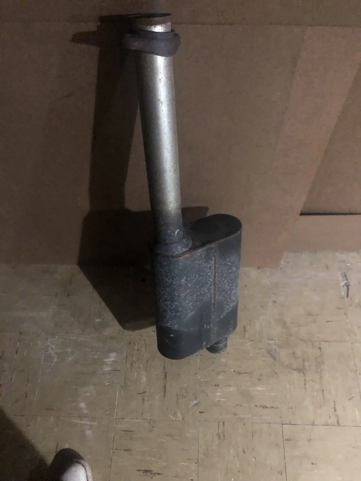

Old
New
Didn’t get to anything else today unfortunately.
