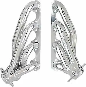

The FRPP shorties are very nice. I think it would be hard to find a better shortie. 1 peice flange, 409 stainless, Jet Hot "Sterling" finish, lifetime warranty. :nice:

If his FRPP shorties for the p heads are coated I doubt it's paint. It's likely ceramic coating like Sleeper's above. And it's the ONLY coating that will hold up on a header long term. The FRPP quality is some of the best around. And the units are made of stainless steel - so ceramic coating is the only option - if you choose to coat them. I recommend it.
