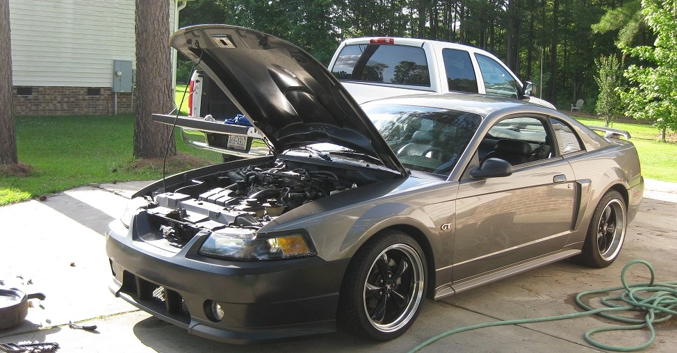

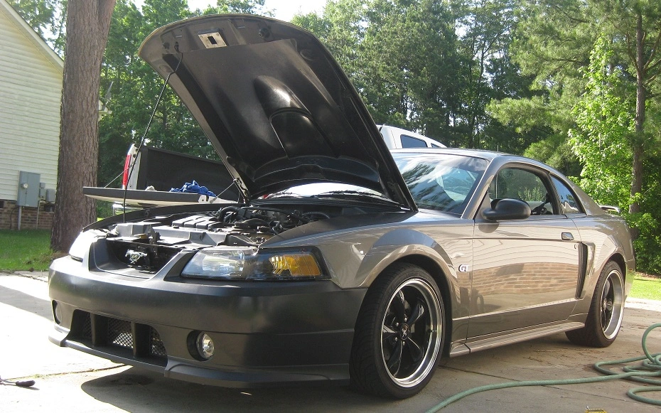

I flushed my radiator and while I was waiting for it to run through... I took some pics of my car sitting there... :shrug:

What process did you use to flush it?
I got a bottle of that prestone radiator flush. I drained the old coolant, ran the flush and water for about 10 mins with the heater on high. Then I drained it, ran straight water for another 10 mins, drained and did it one last time with straight water. I also took a toothbrush and cleaned out the inside of the expansion tank (was nasty... now looks niiiiiiiiice).. then I filled with 50/50 mix and drove for a little while. Topped it off and added some Royal Purple "purple ice" .. I've always used that same process and had no probs.
I did however break the petcock off and have to make an improptu run to the auto store to get a new one.. lol
