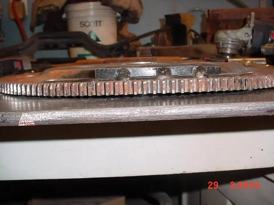

Here you can see the drain plug made an impression in the flex plate...you can also see that the counter weight is welded on the opposite side of the impression...

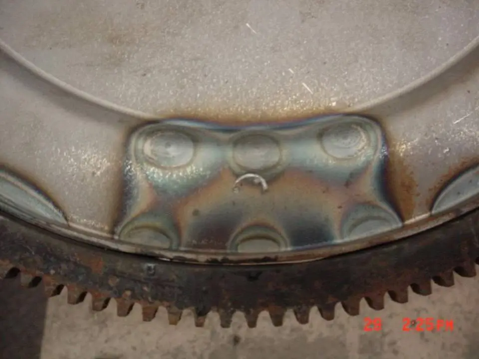

Not easy to see, but this picture shows the flex plate warped from the drain plug bveing in the way.

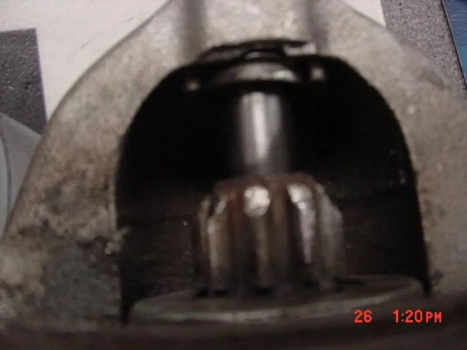

Here is what it did to the starter

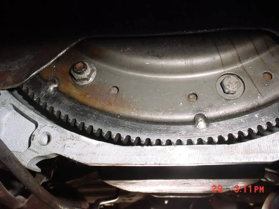

Here is what it should look like with the drain plug protruding through the hole designed for it...
