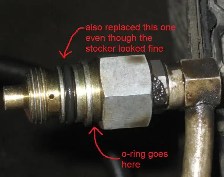

Ok, there are 2 o-rings on the fitting. One smaller one down inside and one larger one that seems to be for sealing the outside. The larger one was pretty dented/flattend and so I figured that's where the leak is coming from. I replaced both of them with new ones from the Ford dealership though and still a slow leak around where the fitting meets the pump.

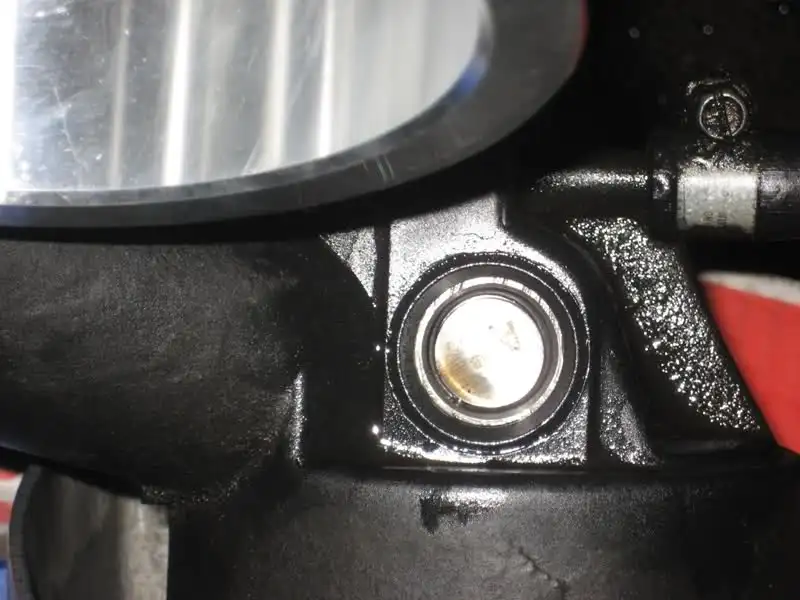

There is a spring loaded plate that goes down into the pump when you press the fitting into it.

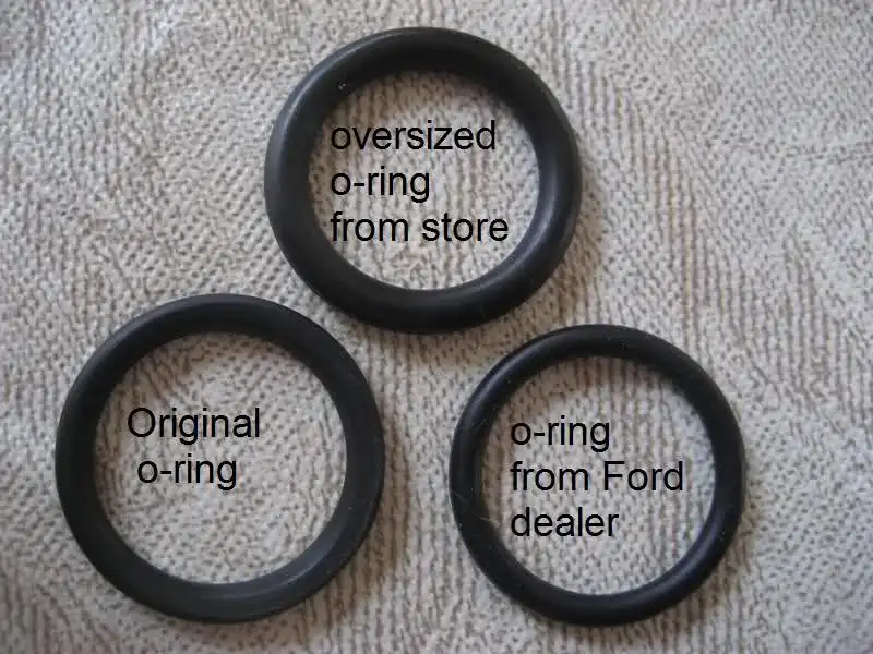

Not sure if anyone cares, but just for the sake of having a fix posted if someone searches.....the slightly oversized o-ring from the hardware store did the trick, no more leaks. I filled the res back up and everything looks good.
awsome. from the pics of the o-rings the one you got from the dealer looks small and def. looks small. what's up with that, you would think it would be a direct fit? and slightly bigger than the worn stocker. oh well glad you are up and running:nice: .
