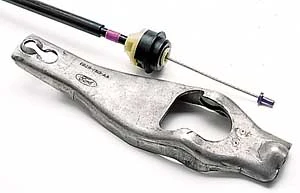

If you haven't found a good place to get a stock cable for cheap then goto Jegs and get the Ford Racing Clutch Linkage Upgrade Kit for $62.99. It comes with a new factory cable and a new clutch fork. :D
