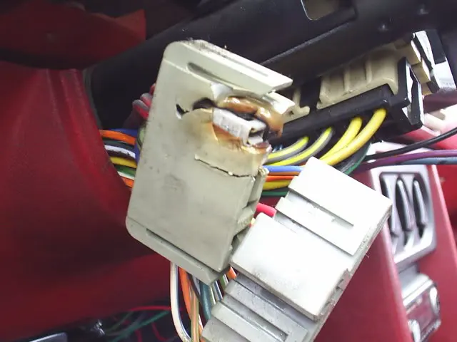

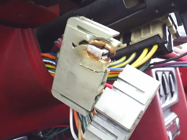

if you are comfy with wiring, it is no biggie. i chose to put the relay in the engine compartment. just wire it up and tap into the feed wire to the lights.
at the switch, find a new feed source (from fusebox, headlight switch, etc) and swap out one terminal/wire.
the alternative is to have the harness catch on fire - which would be more trouble? :)
good luck.
pretty too...
