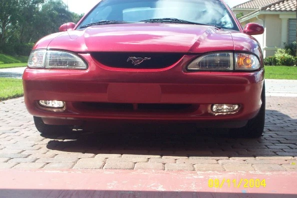

Here are the clears:
And yes, you need a new switch for that little orange thing to light up!
