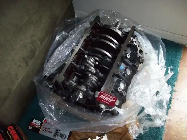

ok getting all the parts needed for a 500rwhp 2v gt

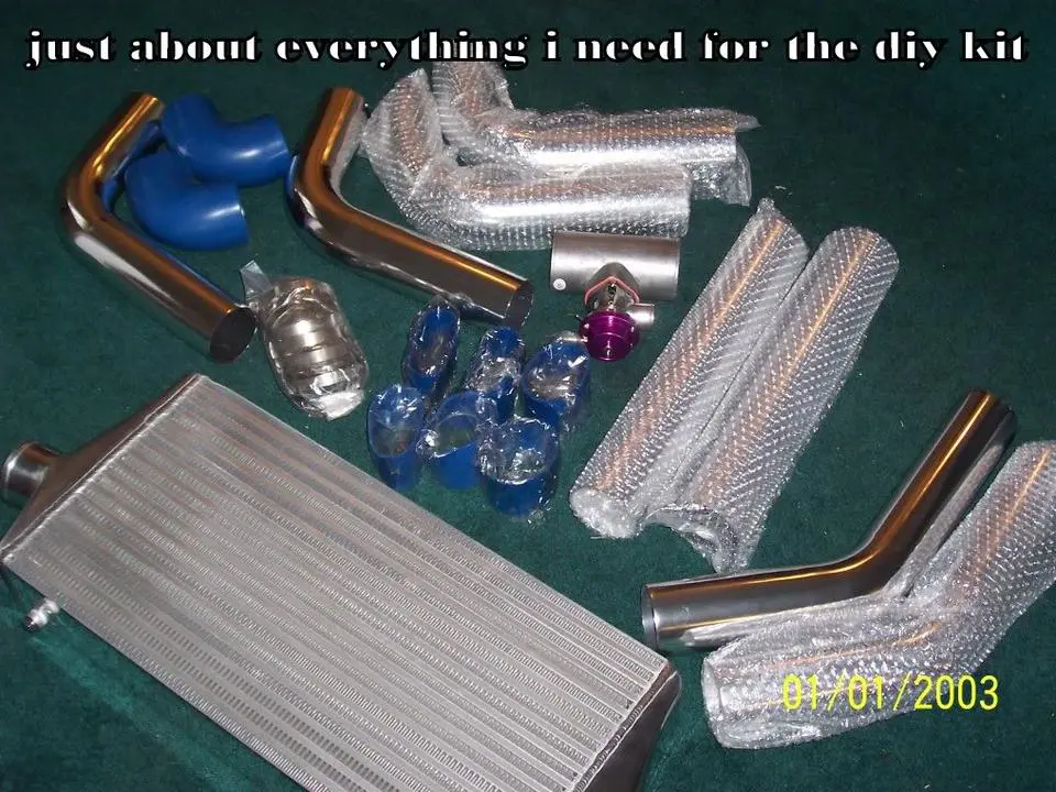

here are some pictures of my progress
i am waiting on my 7qt oil pan w/gasket then i will start putting this thing together

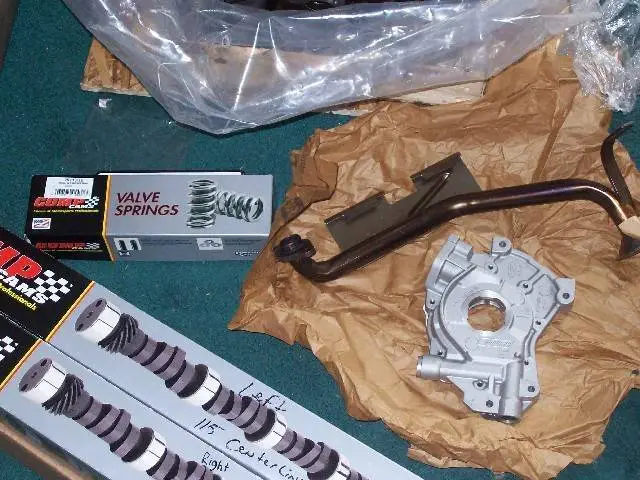

i also need to check on the springs in the heads and the springs i have the car will have a redline of 6500rpms my be even 7000 rpms if i can get away with it safely

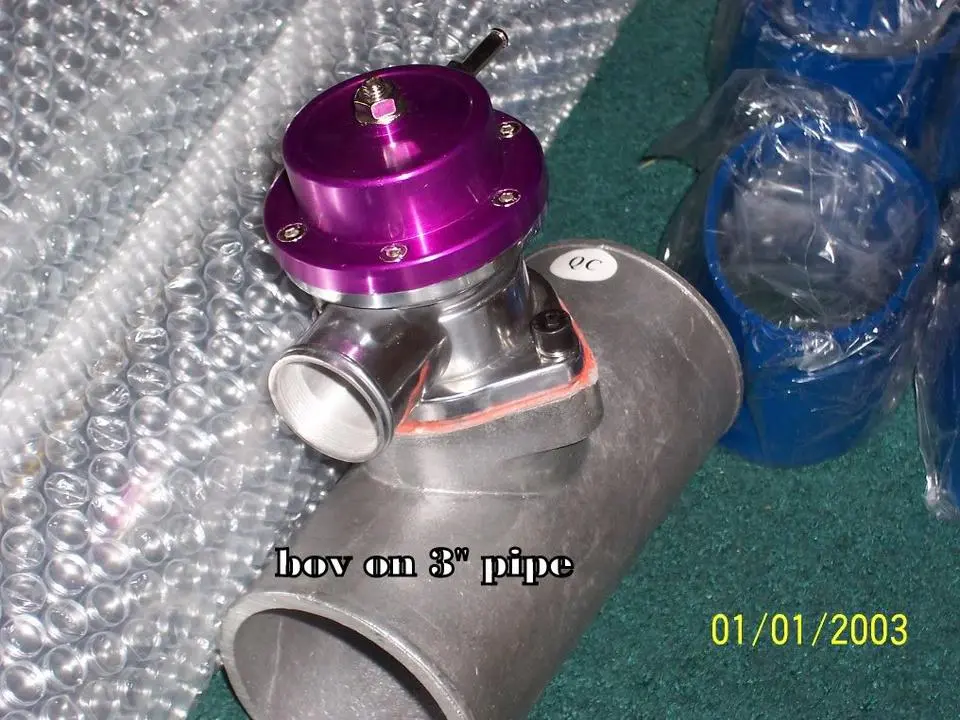

will be replacing that bov with a mini-racing valve from vortech.

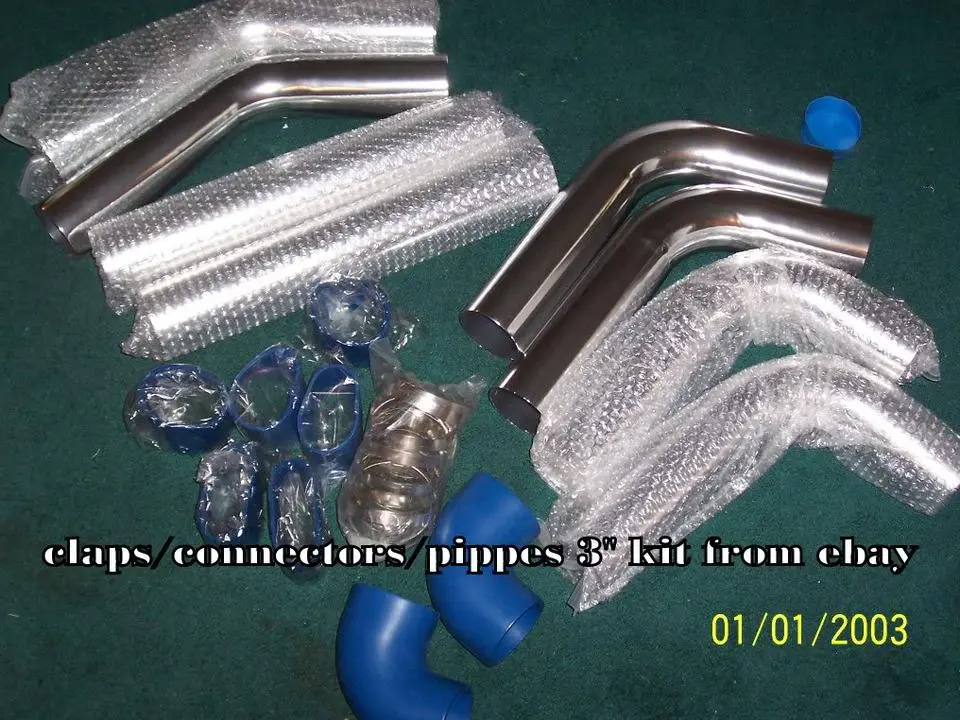

will also be upgrading to some better rubber connectors as the ones with this ebay kit suck
dont have a picture yet but will be using t-bolt type to connect the pipping

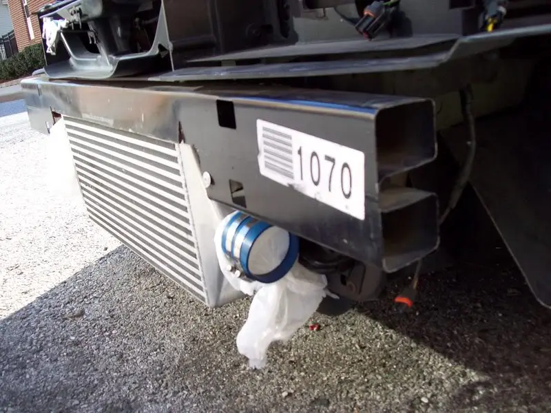

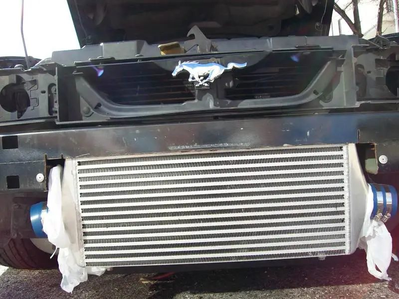

i did manage to mount the intercooler and it fits perfect under the stock front bumper i even had a ricer look at my car and say to his buddy "thats not and intercooler i think its some kind of condencer" i was think hehe cool
i do have an engine stand so i will be putting the motor together at my home wife loves the engine in the middle of the living room "NOT"

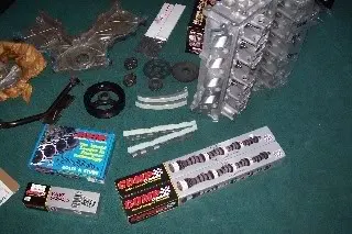

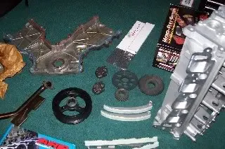

anyways i also have arp head bolts and fel-pro gaskets,2v timing adj. kit and like 3-4 books showing how to set timing on 4.6l so i should be find there
only thing i am pissed about is i got the timing comp. from off ebay they are all in good shape but no bolts so i have to use the ones from the old motor and i was tring to use as little from that motor as possible... but what ever

just check with patriot on the springs that cam with the stg2 heads
they have 115lb seat and 285lb open so that are better then the comp springs i have with 93 seat and 198 open
so i should be ok at 65000 rpms or so spring wise that is still will need to hit the dyno and see where power drops off at
some of the parts :
mmr900 shortblock

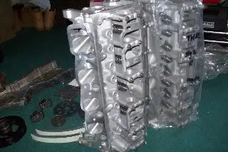

patriot stg2 heads
mph blower cams
arp and fel-pro head change kit
canton 7qt oil pan
other parts are just parts i ordered like
4.6l timing componets
front timing cover
harmonic balancer pulley
diy fmic kit w/pipping

Good luck! What compression is the motor? I don't think you'll make 500rwhp with a 3.33" pulley, though. Get a GI Joe 8-rib kit and a 2.85 pulley :) www.bggperformance.com
Comp has a high load spring now with a 120lb seat.
the shortblock is using 18cc dish pistons and i think the compression is 8.9:1

How do the patriot heads look I'm considering them.
