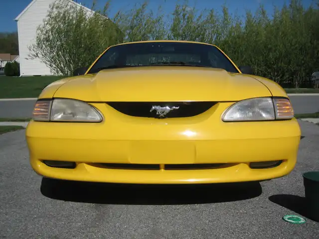

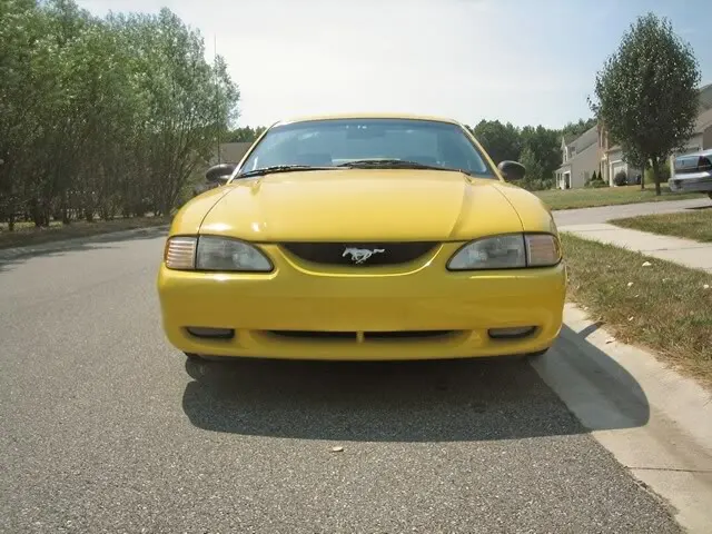

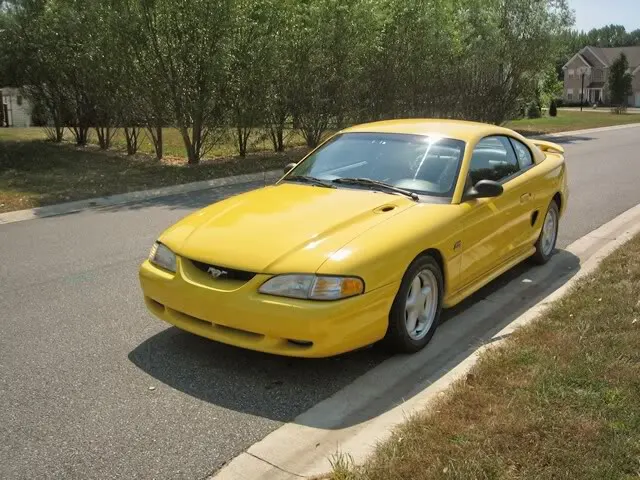

You can see a little in this pic... I actually attempted this before but it didn't go so well so it actually looked worse before then what you see in this pic. But the left headlight is what it looked like somewhat, then I did the right headlight with the crappy compound and it looked somewhat decent.
Then I did it with the 3M again later and it came up even better.
