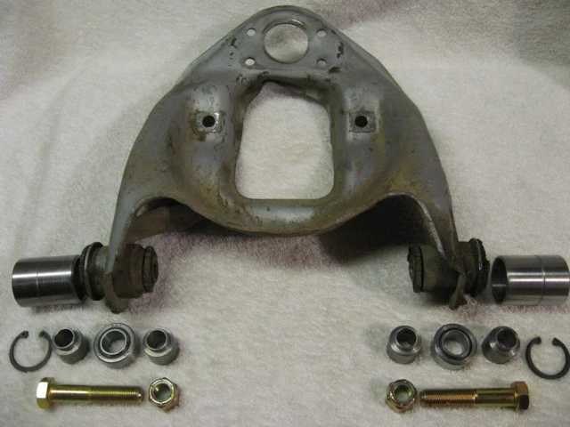

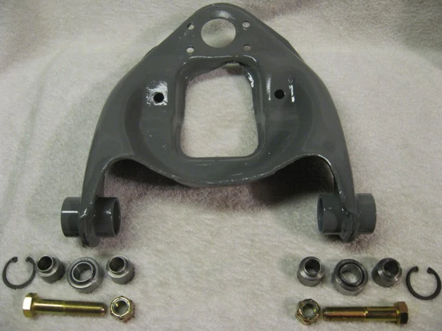

John, would this bearing work for a lower control arm conversion?
http://qa1.thomasnet.com/item/inch-spherical-bearings/ypb-t-series-spherical-bearings/ypb8t?&seo=110&bc=1002|3001276|1052|3001108
I'm thinking of making a set for my 66 coupe. TIA.

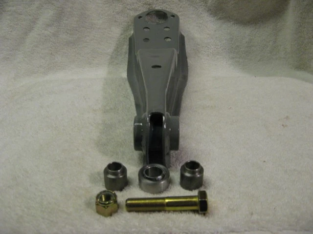

You can make it work with that bearing. The bearing isn't the hard part, making a weld in sleeve with groves for the clips is. We have just the bearing kits for $50ea. They come with the bearing, groved weld-in sleeve, spacers and clips. The bearing we use is a 5/8 spherical, teflon lined, self lubricating rated at 32,000lbs. and made in the USA.
It is a fun project, send me an email and I'll be glad to help you find the parts you need.
John - [email protected]
Is that $50 for both sides or per side? In all reality it doesn't matter that's still better than buying the bearings and having to have the sleeves made. I wish I had a home lathe:rolleyes: than the wife would never see me....wait she already says that:shrug:

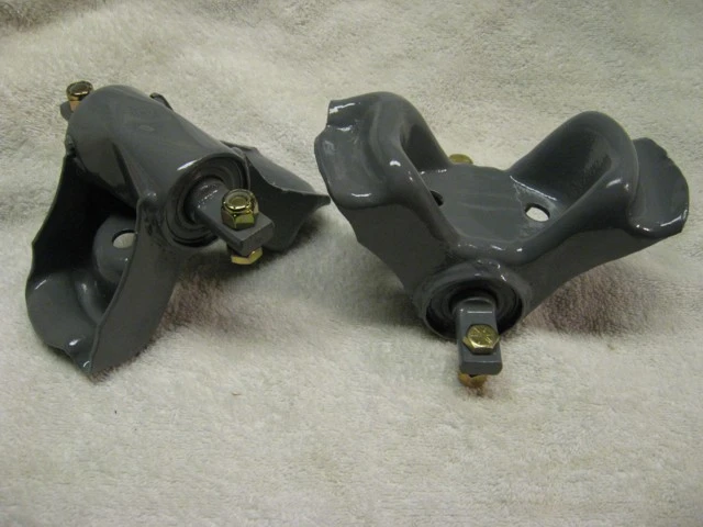

They are $50ea. and you can use them for a lot of other stuff. These are AMC parts I put the bearing kits in. I also put our roller perch kit in a set of AMC perches.
What it takes is a set of used/new perches that have a true 7/8" OD shaft. The original Ford perches have a 7/8" shaft and some of the aftermarket ones do. It's hard to tell some times without taking it apart. I found one set of aftermarket perches that have a tubular/hollow shaft, boy, talk about a scary looking part.

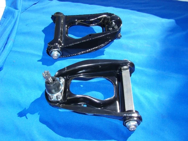

hey john, with the bearing kit you sell, will it work with stock stafts? or do you have to have a custom shaft made?
It's a custom made shaft from 4140 chromoly. The stock shaft won't work with our bearing kit or any other that I could find. I spent over a year in development of the roller UCA's and the design of the shaft was most of it.
Have you thought about taking you upper a step further & putting the drop in the shaft, so no hole drilling is required? I noticed TCP is now doing this. It would be a bit more fabrication as the stock uppers would hit the shaft & need to be modified not to hit the bolts/shaft & strengthend.
I just noticed today that you are now selling a kit to modify uppers. When I get closer to complete on my car I may be going that route.
