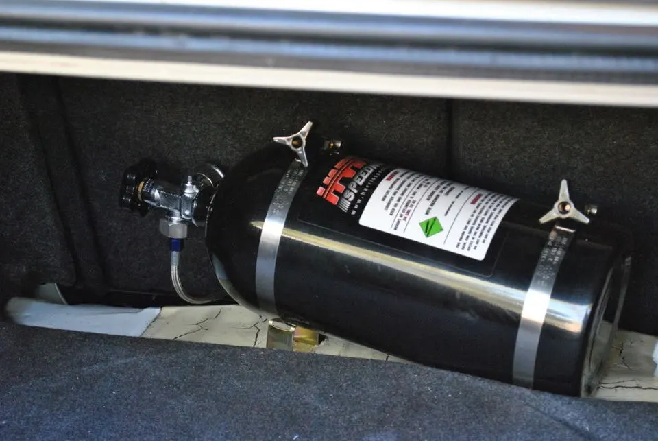

Behind the rear seats, slightly angled so the nitrous feed to the back of the bottle under acceleration.
I can also read the psi gauge this way, and open/close the bottle from the drivers seat. Doesn't take up much trunk room either where it's at.
