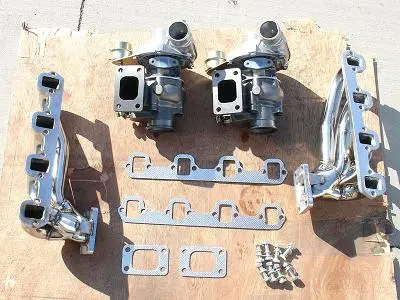

Here's some of the more major stuff, down pipes, fuel system upgrades (255lph fuel pump, 42lb injectors), feed and return oil lines for turbos, cold side piping/intercooler, blow through maf meter, misc. fittings and flanges to plumb everthing. I'm missing some stuff i'm sure, but these are the most of the major components.
Also if you were going to go with an intercooler or 2 intercoolers. I did a JYTT install on my 91 I had and I did two smaller intercoolers, one for each turbo basically. They were intercoolers from 88 turbo coupe thunerbirds that I got off of ebay for $30 bucks a piece. They worked pretty well and it was pretty cool seeing two intercoolers tucked up by the radiator. Something pretty important to have since the Air charge with a turbo setup is so hott because of the turbo's. Other than that all the big stuff has been hit. If your planning on doing a DIY build with this TT kit make sure your ready for it. Its a big build. I would allocate at least $1500 for just random parts that your going to have to run out to the parts store to buy to make things work. Also don't forget your going to have to tap the oil pan for the oil return for the turbo's. I am not trying to discourage you from building a TT setup but it can be a PITA at times so make sure you do your research and are ready for the build. Good Luck.
I see...this is the stuff that comes with the kit, it ison ebay item #330077010994
and the stuff you see in th epic is the only hting that comes with it. I htink this guy sells the turbo headers and the twin turbos for $700 new. I know i still need some more stuff but I believe these are the major componets right?

Those turbos already have wastegates on them. If you are interested in going turbo, I would highly recommend visiting turbomustangs.com. Register and then just looking around and see what everyone is doing. There are two sections where people do their home built stuff "DIY/Junkyard" and "The Builds." Also, the "Newbie Tech" would probably be quite helpful (no offense). I know for a fact there is a guy on there that bought that exact same kit. He said it looked half-way decent. It's hard to go wrong with TIG welded ceramic coated stainless steel. Just check the flange thickness. As for the turbos, who knows. But, for $700 for the whole gitup, it's hard to go wrong. Heck, I have $500 in my single MP T70.

I'd stay away from that if at all possible. Maybe not so much the turbines (though they prob wont last long) but the headers will definately be of a low quality and have to be repaired once they crack.
Like some said though get over to turbomustangs.com and start reading.
B&G turbo has some pretty cheap headers that you could use over those with much better results. And IMO you should go single. So much power to be had with a Master Power T70 and you can have a brand new one for ~500 and be MUCH MUCH more reliable (as far as the turbo kit is concerned)

As a welder with 7 years welding. I say they are ok headers, but I did mod the headers a bit. Yes you can get beater, but you "WILL" spend more. I got the set for $120 after shipping.

Really? I was under the impression the metal was thinner than most headers no? Of course you will spend more but you will also get what you pay for. If you're just trying to do it on the really cheap, flip the shorty headers.
