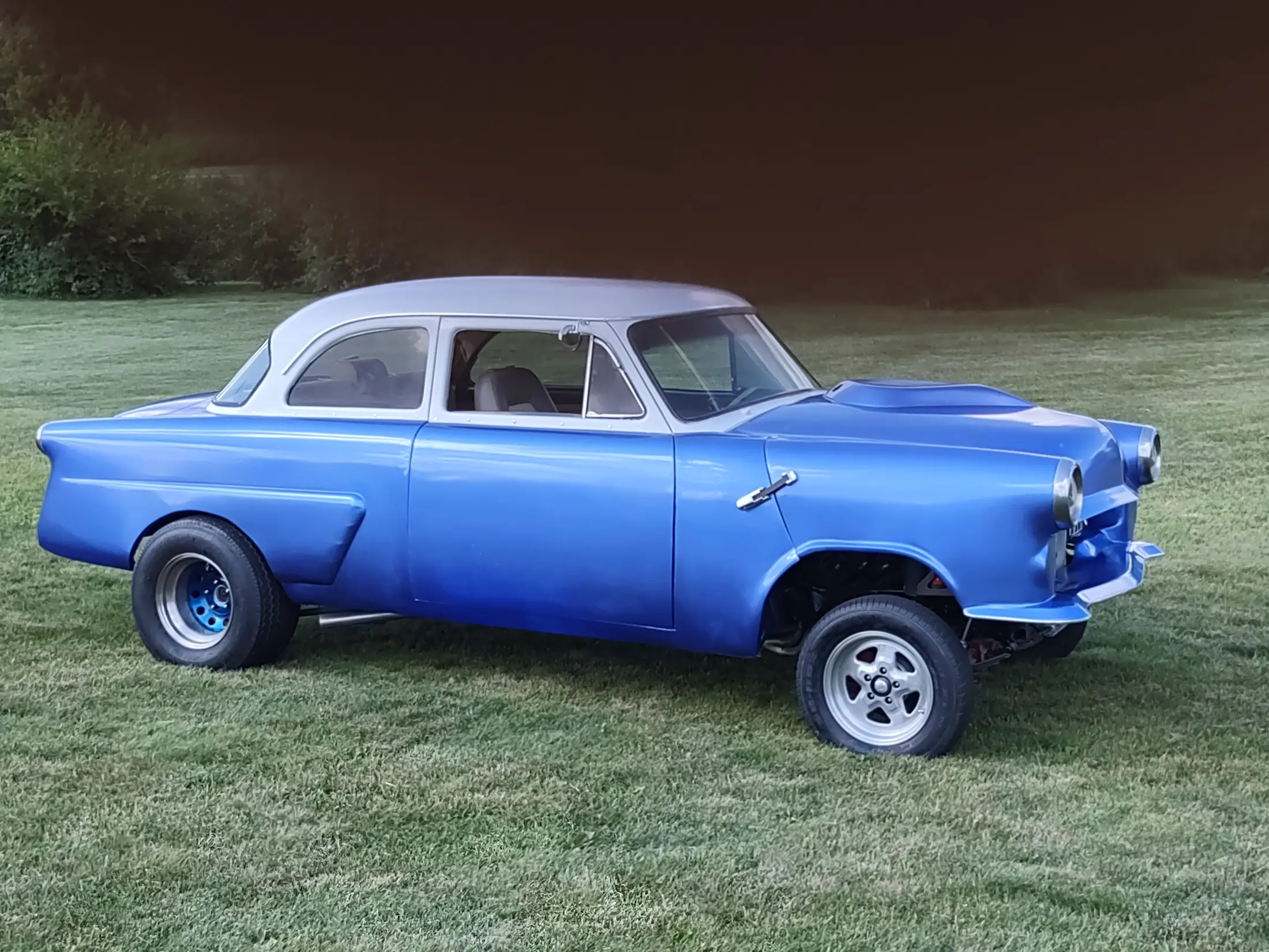

Take the AOD fill tube to the parts store or your local Ford dealer to match up the O-ring. Add a little RTV to it when you install after cleaning the transmission fluid off of the tube and the top of the hole where the stick goes into the AOD. If this has to do with your gasser, it almost looks accesible with the flip front open.

I did that and they found what I needed. TY
