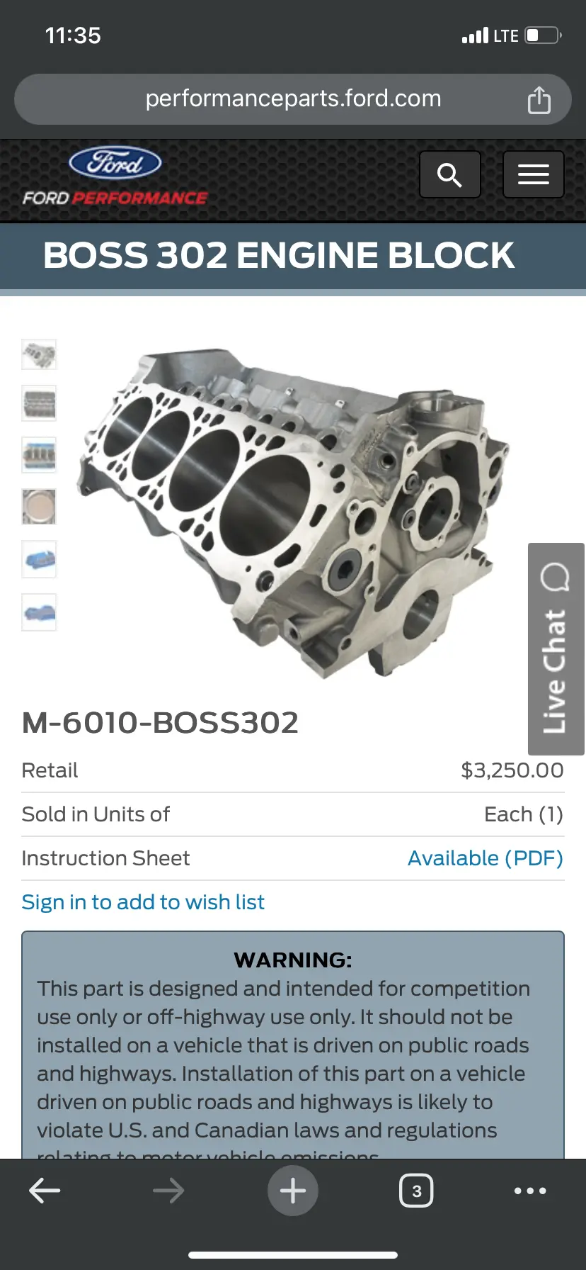

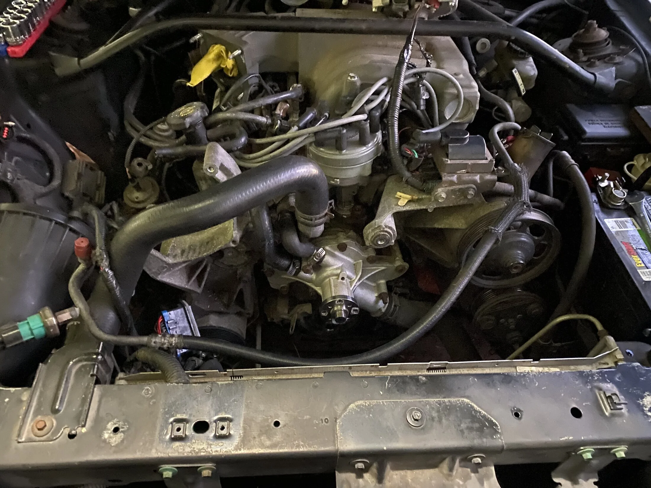

Is the boss 302 block the same as the 302ho in my 1995 GT? I’m looking at a little boost after I get engine together. and have considered going with the stronger boss block. I could start from scratch.
What I’m asking is if all my 1995 tech era bolt ons will work here. I’ll upgrade but not gonna change intake style.

Could anyone tell me first hand if I stripped my ford 302ho from 1995 down, -and set it beside this Ford 302 Boss block what would be different?
Saying as if I didn’t change nothing.
Would the idea of 302 boss block be interchangeable but stronger with 95 Ho Equipment? I do realize that outside of a drag strip and 550 Hp a boss block isn’t necessarily needed.

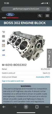

Is the ford boss block here The same blueprint and engineering as the 302ho? Is it only a better block?
I heard I could chance 302ho numbers for a good block number and year for a clean build swap.
I guess im begging to know is the 302 boss a clean swap better block.
Your 95 block has no 4 bolt mains or screw in freeze plugs
It is good for 700HP IMO as is

So the 302 roller cam block started making appearances in Ford vehicles in and around 1985 all the way through 1995 in the Mustangs and continued into 2001 in the Explorers. They have been beat on like a stepchild for a long time and basically once you get past 500 fwhp its a crap shoot on when (not if) it will give up the ghost. Me personally I think a stock motor with a turbo seems to last longer followed by naturally aspirated then blowers and nitrous seems to end them the quickest but I will admit that it mostly bad tuning.
With all of that said to me it sounds like you are going to build a very mild combo so skip the heads, intakes, and cam and add boost of your choice and get it tuned. You can make 300 to 350 rwhp and it will be very docile and fun to drive.
There are a couple guys on here that can guide you on this and believe me it will be a lot simpler than a HCI swap that will cost as much and produce less power.

First off, the FMS Boss 302 block is much stronger than a stock 302 block.
The Dart Sportsman block is much stronger than the FMS Boss block.
The FMS Boss 302 block has shorter skirts than the Dart Sportsman block, so stroker kits work "better" with the Dart block.
An original Boss 302 was a heavy duty 302 block with 4 bolt mains (center 3 only) and screw in freeze plugs.
The original Boss 302 used a Cleveland 4 bbl cylinder head. This required a unique intake manifold.
Any Boss 302 block (FMS or original) can use any aftermarket or stock SBF cylinder head.
A Dart Sportsman (or Iron Eagle for that matter) have much more material around the cylinders, so much larger over bores are possible, upwards of 4.200 inch.
A Dart Iron Eagle block has 4 bolt mains (splayed) on all 5 main bearings. It is capable of supporting over 2,000 HP.
The Dart Sportsman block is capable of supporting over 1,500 HP.
