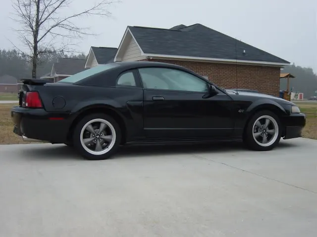

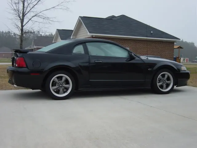

I've had mine for about a year now and I don't have any complaints. I like the look and the ride. The install was much easier than I expected. I don't need c/c plates and I'm still on the same stock shocks/struts that came on the car. It dropped the front about 1 1/4 inches and the back about 1 inch. I cut 1/2 of the dead coil off of the rear to try and get it a little more even to the front. It still has a little rake to it, but I like it. Well worth the money to me.
Here's a couple recent pics:

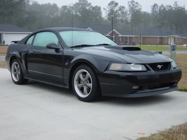

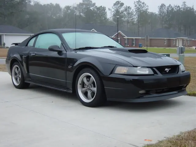

I did the same as MaxxMundo and cut an extra 1/2 coil from the rears. It's been about 2 years and I like them, honestly if it lowered the car any more I'd be scraping the speed bumps around here.
