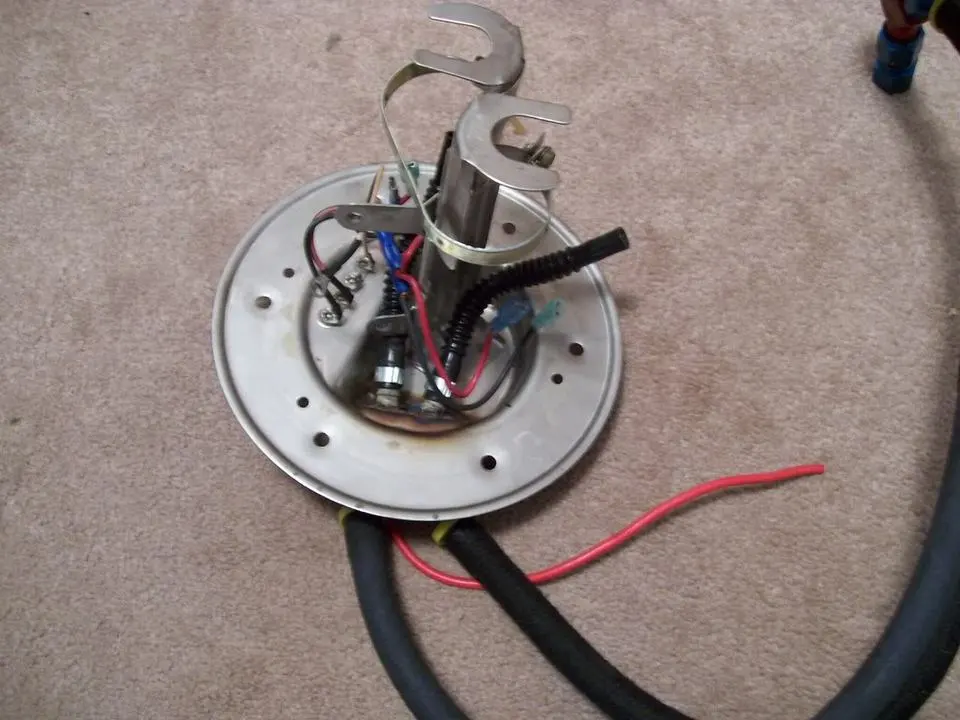

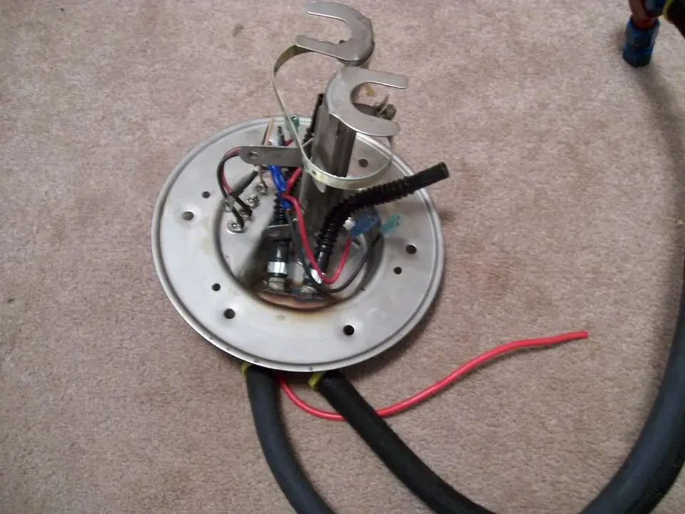

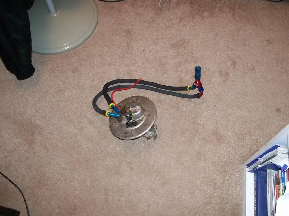

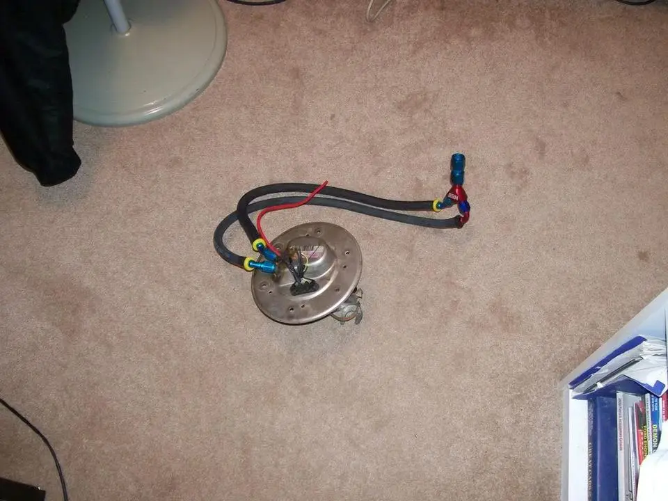

This is the modified hat I had already bought. The seller just upgraded to the fore hat, but I dont see it flowing any better than the 2 seperate lines the modified stocker has. But it does look alot better haha.

so i guess ill be better off with a single gt pump then.
Yes if you EVER plan on pushing your stock motor past the normal 8PSI that most run. If your certain that you wont push it and just arent that sortof person, go for the plug and play focus setup.
