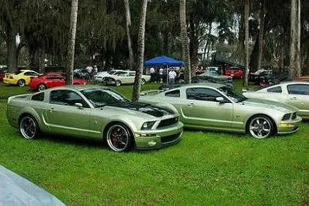

Love those K springs!
I got them installed thursday night, and took the car up to Silver Springs for the 14th Annual Mustang Round up on Sat. We average 80 and up to 100 a few times. The handling was solid and not springy. We took a few big cures and it was nice.
The over all ride quality is excellent. It's firmer than OEM, and even stiffer when you throw it in to the corners. I have the GT oem struts and springs. I'll upgrade those early next year.
I have 20" deep dish Bullit's and the difference between the top on the tire and the bottom edge of the fender lip is just over 1 inch in both front and back.
Here's a pic of my car along with some other Limers. I have the center GT with the anthracite bullits.
Here's a link to the LLR website have several post with pics of the car show.
http://www.legendlimeregistry.com/forums/?t=3406&s=1
Thanks, Dewman
