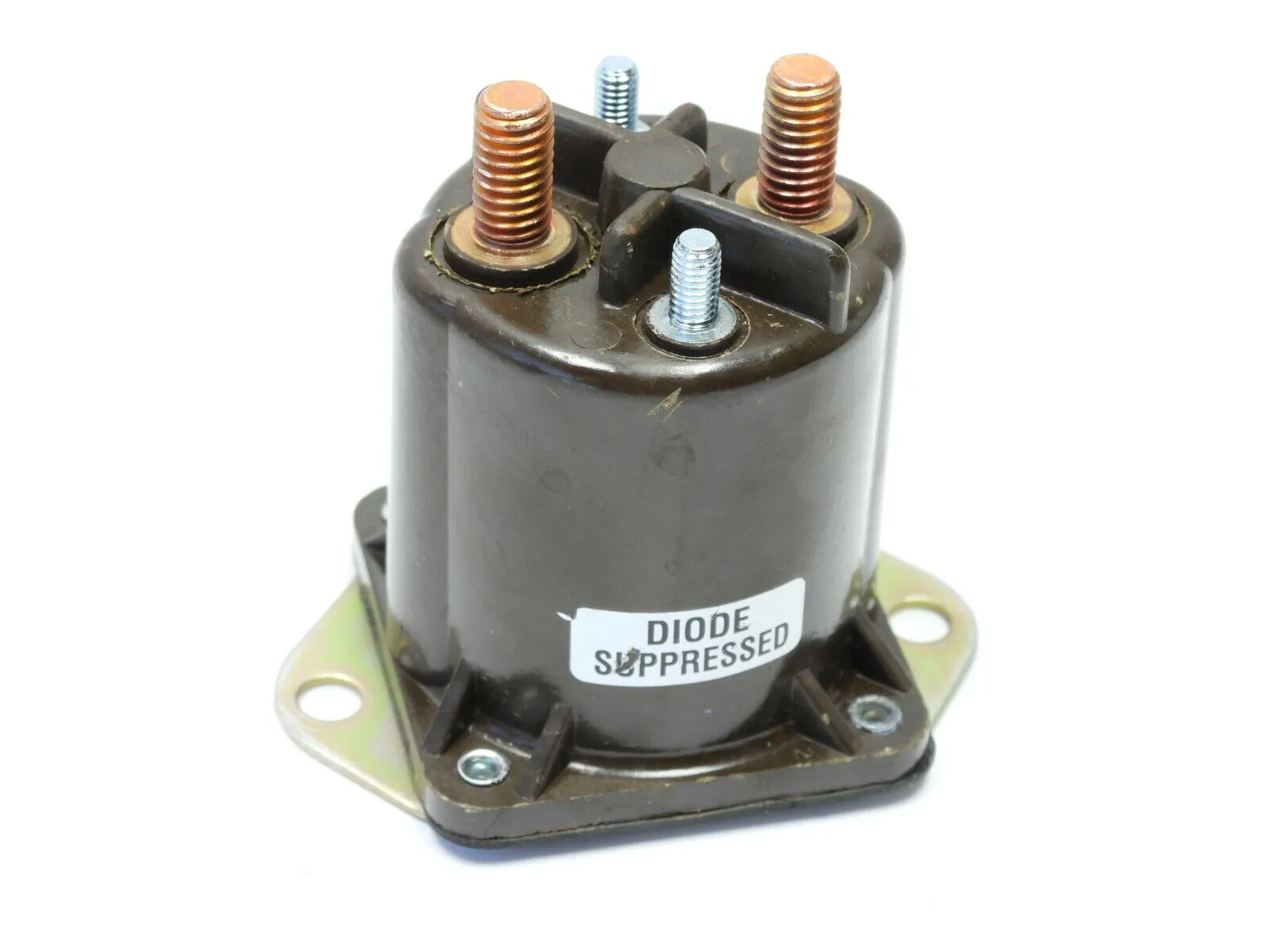

OP ;- Take a screwdriver and jump the battery terminal wire to the solenoid trigger pin..If the starter triggers its the ignition switch..
If the starter doesnt trigger get a new diode suppressed starter solenoid................
