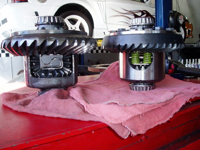

Cheap is not always better. I think you can tell by the pic which is better.
Eaton Posi Vs. Stock.
