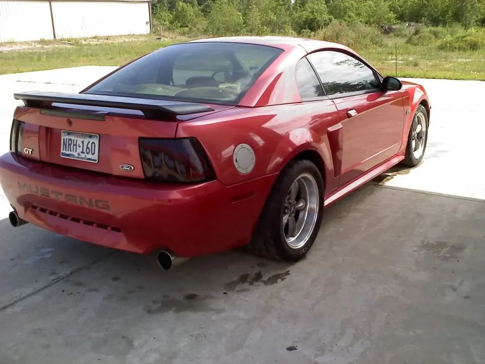

i have them on my car. cut one coil off the rear and leave the isos out. if you dont the rear will sit about the same as stock. i will try to post pics of my car for you.
J
jlds91389
Feb 1, 2009
241
Orange Tx
May 4, 2010
  • May 4, 2010
this is my car with c springs. i have isos in the front none in the rear and cut one full coil off the rear to.. still have stock shocks and struts and it rides fine
