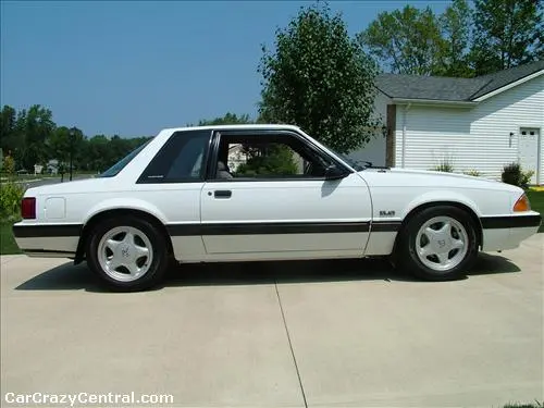

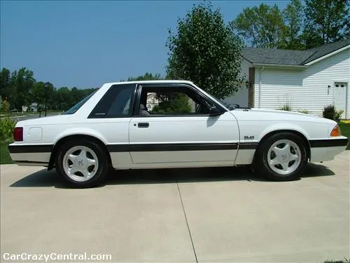

Eibach sportline 2" drop

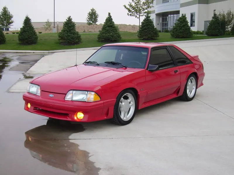

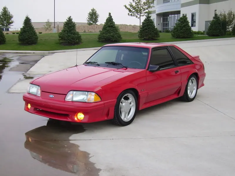

Eibach pro 1.5"

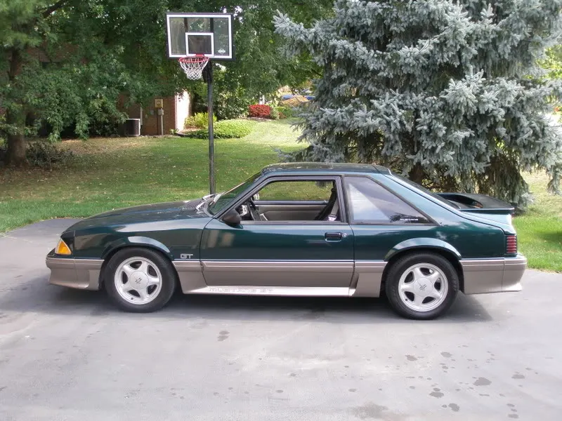

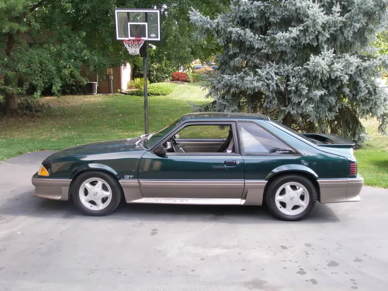

Ford "B" springs

Ive got B's with no rear isolators.....the FRPP springs tend to give a raked look from what I've seen. They ride decent....I have KYB shocks/struts so they are the culprit from what I can tell for my sort-of-****ty ride feeling...
You'll need C/C plates too....don't buy Granatelli (they break). Thats my input

I like them. The ride is not much differant from stock. That will of coarse depend on how stiff a shock you run also. If this car goes to a track it will be a straight line. So a stiff spring offering onlya harsh ride wasn't needed or wanted. No isolators front or back and rarely hear them make any noise.
